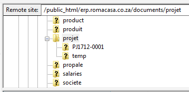

Hi all,
I am using 6.0.3 n a hosted server with MySQL and Apache.
I created a project as a template with tasks and other details in however when I clone the project and try to change the project ref, I get this error:
Failed to rename directory ‘/usr/www/users/r\*\*\*/_ **/documents/projet/PJ1712-0001’ into '/usr/www/users/r** _/\*\*\*/documents/projet/GOLDBERG’.
Does anyone know what the problem might be?
I have found the folder in my hosting and could rename it but I don’t see any of my other projects there, does anyone know why? Or where the project folders are usually stored. I though that they would be in the DB with a pointer not a folder in the host tree.
![20180113_FilezillaProjectsPath.png](https://www.dolibarr.org/forum/uploads/dolibarrorg/original/2X/3/34754db25395ac3bc1d7d2097fd5f327c9f95a08.png)

Both could be related ( no other project’s directories and not possible to rename one)
When you log on your server you may not have the same rights as the APACHE user (www-data) therefore you are able to do modification but not your server
A way to check if APACHE has the rights is to save an attachment on a project.
1- check that there is no configuration that could prevent APACHE to write in the document directory
2- check the right on the document directory , either add read and write rights to all or change the ownership to the APACHE user.
Note: Documents are managed based on the directory, nothing is saved in the database.
