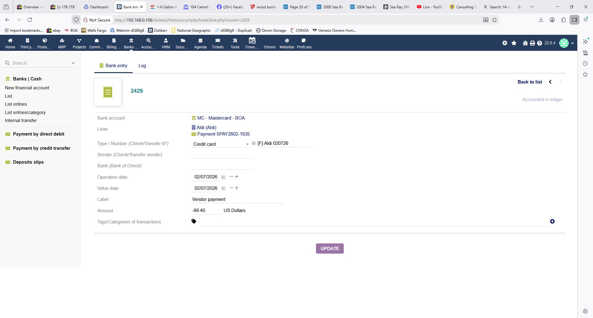

For the last couple of updates, when I add a tag to a banking transaction, the tag data doesn’t display when later retrieved. However, the data tag is being recorded because when searching for that specific tag, a list of those tagged entries is generated.

Attached are several screenshots of the problem.
From Banking → Bank Account → Bank Entries → Bank entry

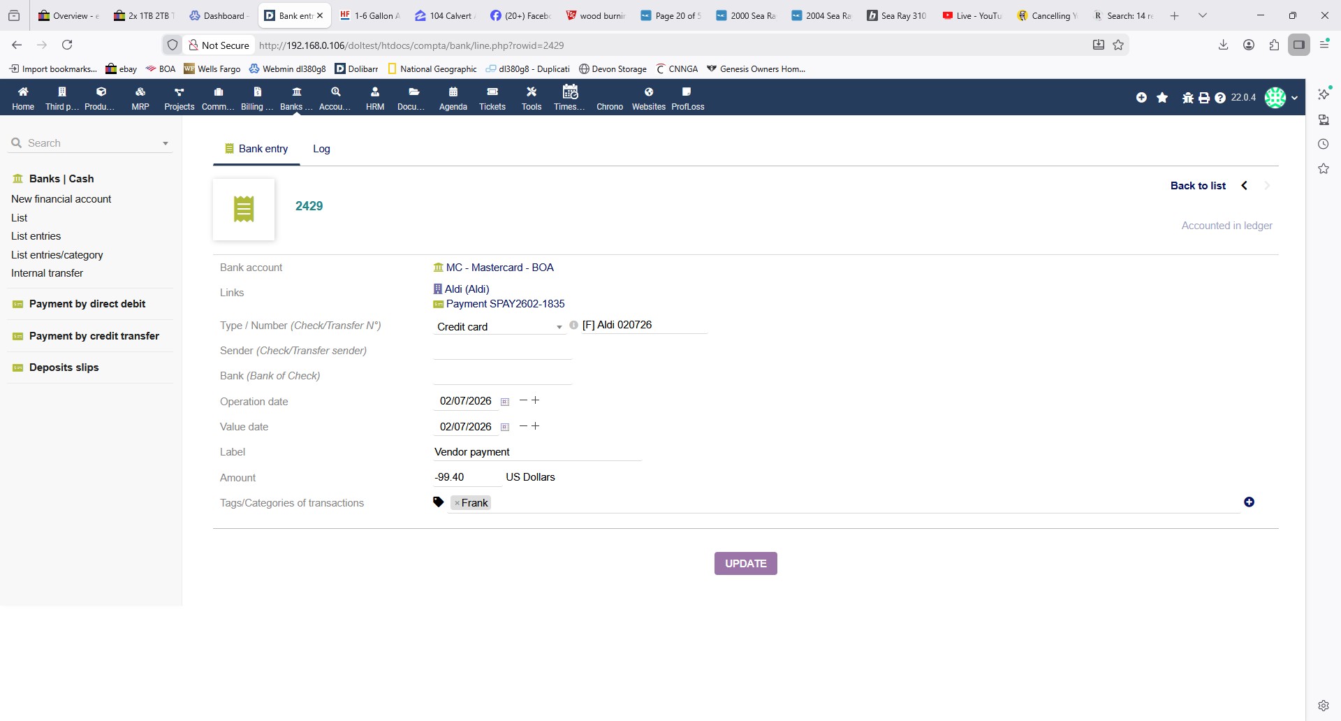

When I add my tag - in this case “Frank” and update it, I get this.
fW
Sorry, I am confused, it does say Frank as a tag in the last picture?
I’m sorry for the confusion. I will try to explain what the issue is again.
When I pull up a banking record, the “Tag/Category” is blank. If I edit that record with a “Tag” and “Update” the record, the record reflect the “Tag” that I used.

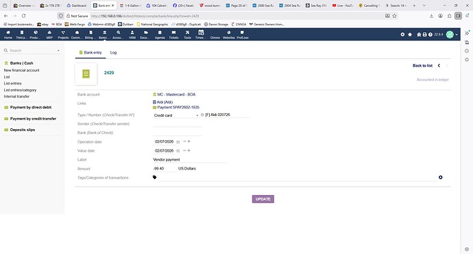

However, if I retrieve that same record again at a later time, the “Tag” is not displayed making it seem like it had never been tagged before.
On the other hand, if I search for records with that “Tag” a full list of records with that “Tag” are displayed.
For whatever reason, when pulling a specific record, the system no longer pulls and displays the “Tag” field.
Thanks for your help. Frank
