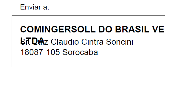

Please see below the snapshot of the output of pdf_azur.modules. The sender (customer area is ok) name overwrites the sender address. I tried too much to solve it but no success. Please give some more help for this bug. I am sorry for annoying you too much.

I’m still getting the overwrite of the persons contact name with the company name. This is in 3.3.1. See attached screenshot.
