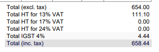

So I made a new template : https://github.com/ksar-ksar/Dymo/blob/master/pdf_as32.modules.php
With the following code :
$total_ht_13=0;
$total_ht_17=0;
$total_ht_24=0;
$nblignes = count($object->lines);
for ($i = 0 ; $i < $nblignes ; $i++){
	if ($object->lines[$i]->tva_tx == "13.000"){
		$total_ht_13 += $object->lines[$i]->total_ht;
	}elseif ($object->lines[$i]->tva_tx == "17.000"){
		$total_ht_17 += $object->lines[$i]->total_ht;
	}elseif ($object->lines[$i]->tva_tx == "24.000"){
		$total_ht_24 += $object->lines[$i]->total_ht;
$index++;
$pdf->SetXY($col1x, $tab2_top + $tab2_hl * $index);
$pdf->MultiCell($col2x-$col1x, $tab2_hl, "Total HT for 13% VAT", 0, 'L', 1);
$pdf->SetXY($col2x, $tab2_top + $tab2_hl * $index);
$pdf->MultiCell($largcol2, $tab2_hl, price($total_ht_13, 0, $outputlangs), 0, 'R', 1);
$index++;
$pdf->MultiCell($col2x-$col1x, $tab2_hl, "Total HT for 17% VAT", 0, 'L', 1);
$pdf->MultiCell($largcol2, $tab2_hl, price($total_ht_17, 0, $outputlangs), 0, 'R', 1);
$index++;
$pdf->MultiCell($col2x-$col1x, $tab2_hl, "Total HT for 24% VAT", 0, 'L', 1);
$pdf->MultiCell($largcol2, $tab2_hl, price($total_ht_24, 0, $outputlangs), 0, 'R', 1);
The result is : image
Of course it could be improved.
Let me know if it work.
Yes Yes Yes…work perfect!!!
Thanks for all
