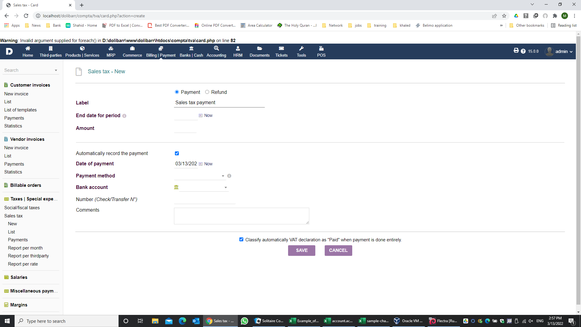

I was wondering why i cannot use under Billing | Payment under Sales tax to make a payment on 31 Dec 2021 (with the amount of credit needed) please correct me if i was wrong with this workaround
Debit Account and Credit account in Value Added Tax, Picture below is showing you Payment and Refund (Refund is Your Collectible (Assets Debit (AR)) from your Tax Provider, Payment is your Liabilities (Cedit (AP)) this you need to pay since you had collected this from your customers.
Input VAT this is Always a debit side - Assets Side ( results from the Purchases or Expenses or Cost)
Output VAT this is always credit from your Sales Activities, Liabilities Side
Now if your Input VAT from the Assets Side is more than your Output VAT then that is the time you need to claim for a Refund.
Otherwise:
if your Output VAT is more than your Input VAT you need to pay it, as it is your Liabilities from you Tax Provider, Accounts payable since you have collected this from your customers or client.
Now lets go back to your Question: Credit Account or Debit Account???
