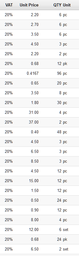

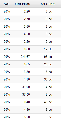

do you mean something like this?
To add the “unit” field to the product forms and the prints, you have to add a new constant in the “Setup > other” screen
The constant name has to be PRODUCT_USE_UNITS and the value must be 1 to activate it.
Check this link
https://wiki.dolibarr.org/index.php/Setup_Other
Thank you. It works for my Dolibarr
