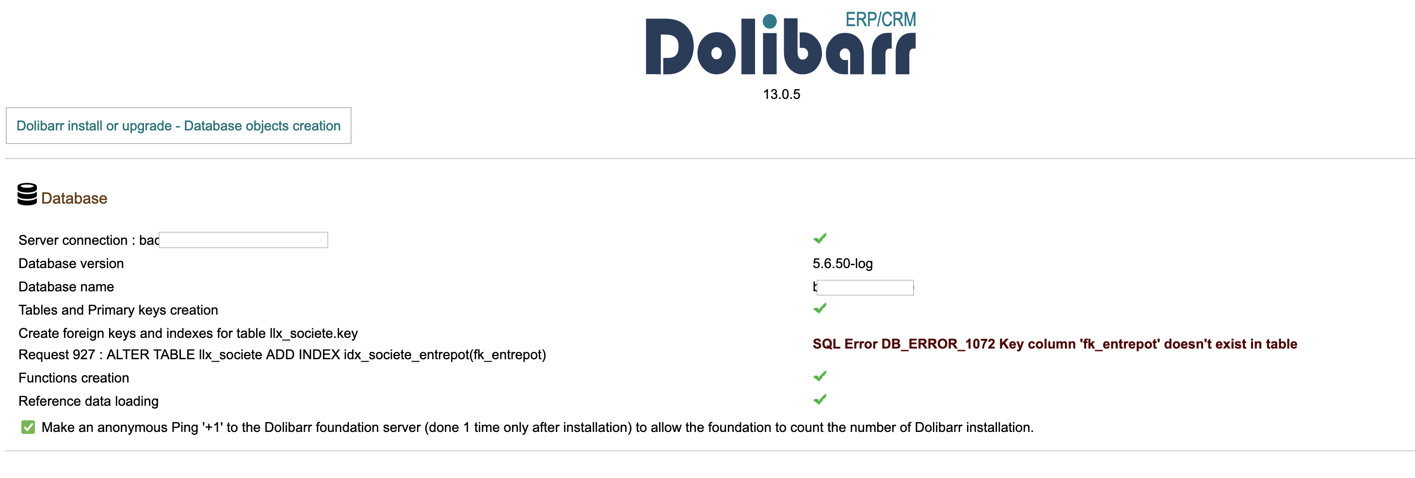

As usual, I updated Dolibarr (13.0 to 14.0.3 version) but the message after the installation process is still the same:
"The application tried to self-upgrade, but the install/upgrade pages have been disabled for security (by the existence of a lock file install.lock in the dolibarr documents directory).
If an upgrade is in progress, please wait. If not, click on the following link. If you always see this same page, you must remove/rename the file install.lock in the documents directory.
[Click here to go to your application] "

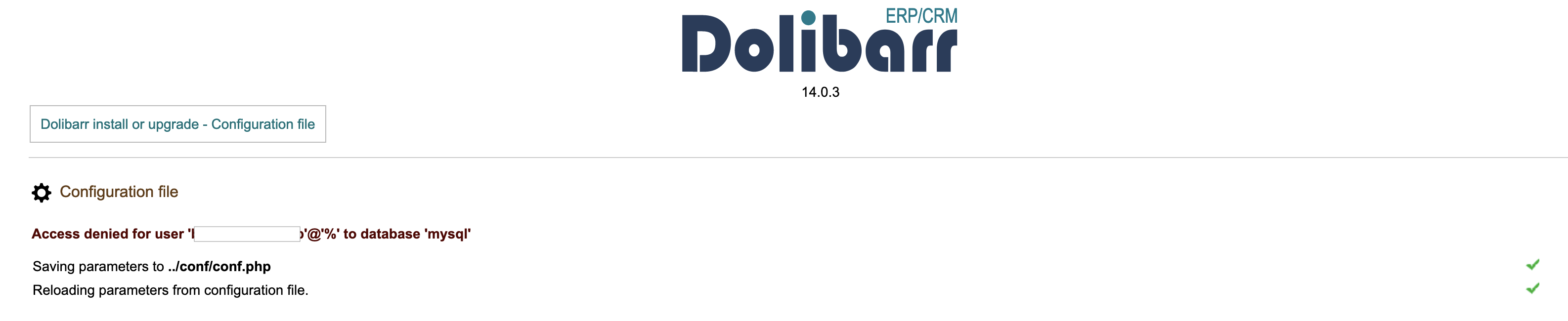

During the installation, the user or SuperUser access is denied:

  1. Removed the file conf.php and reinstalled from start
  2. Renamed the install.lock file (444 permission)

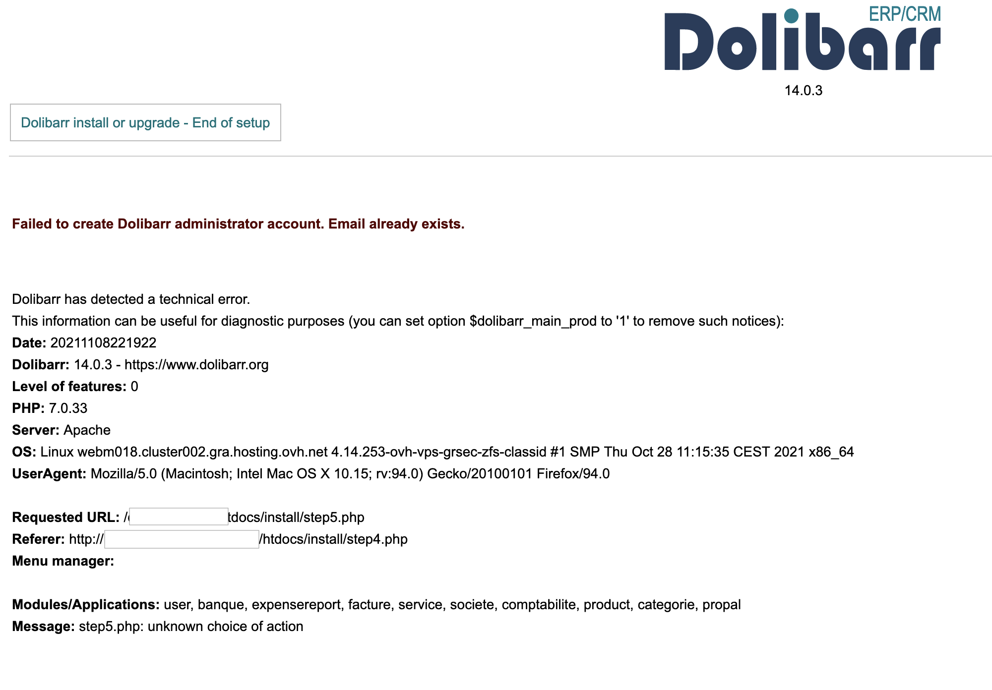

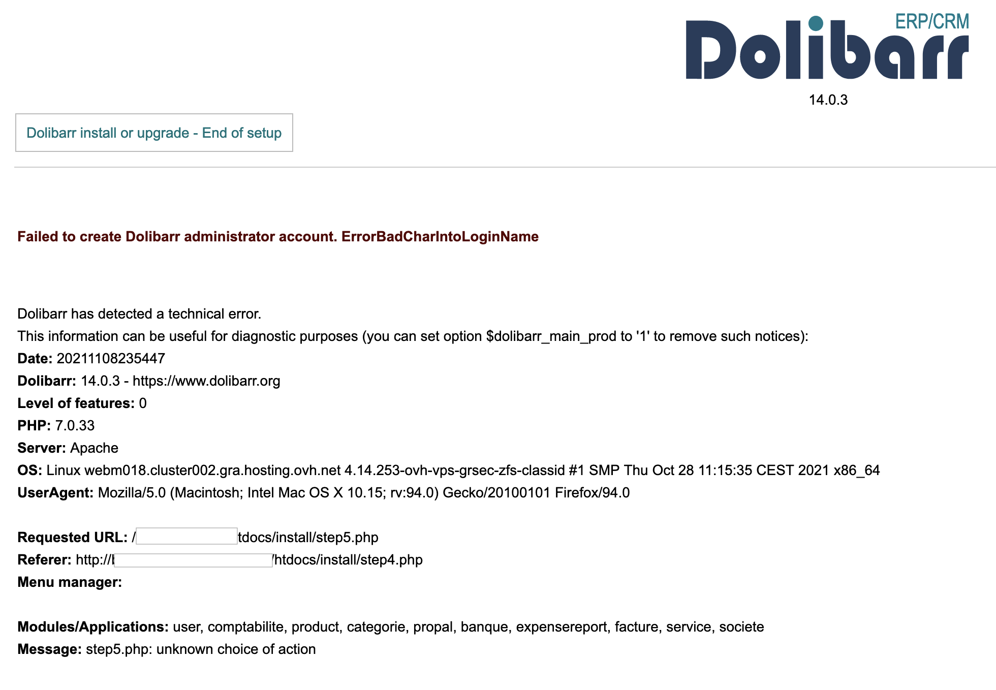

I did it and the process is a loop.
The point is that the process blocks when the Administrator Account has to be completed.
It is already existing so I insert the same user name + psswd ; even if I create a new user !
Do you think I should I remove the existing one in the Database ?
Thanks.
Raf
Hello
Temporarily edit the email for the admin account in the database then re-run the installer. Try that.
Hi aljawaib,
I edited, even removed the User info in the DB but the message is still indicating error:
Do you think that if I save the DB then I create a new one with new User/Psswd and finally restore it, it could work ?
Thanks
Raf
yes it should work.
Keep a backup copy of the database though.

I had to reinstall the previous version (13.0) and restore the DB.
Before upgrade it to the last version, I have to fix the following message:

You seem to have a problem with this database table. The fields don’t exist. Check you database installation files (install folder) to see if you can identify in which version those fields were meant to be created then try to create them. Thats how I would try to approach the issue.
