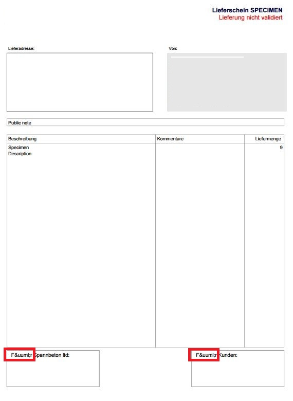

hello!
at the moment i have a problem when i generate a bill of lading. on the buttom of the document there are two boxes for signatures. why is there in both boxes the following sequence of characters? it is: Für
we use version 3.6.1
is it possible to remove that?
i hope someone can help me!
found the solution. it was a matter of special characters. for any reason special characters sometimes cannot be displayed the right way. so i changed it in the language file.

vi htdocs/langs/de_DE/main.lang
/Für
Should work as expected - BUT doesn’t …
Som weird UTF8 vs. Font problem???
Best regards
So, here comes a solution I’m using in version 3.8.2 (OS: Linux).
In file … htdocs/core/modules/livraison/doc/pdf_typhon.modules.php locate below function and copy the commented lines (using ‘html_entity_decode’) into your file. Save (and in case of PHP opcache) restart PHP:

        function _tableau_info(&$pdf, $object, $posy, $outputlangs)
                global $conf,$mysoc;
                $default_font_size = pdf_getPDFFontSize($outputlangs);
                $pdf->SetFont('','', $default_font_size);
                $pdf->SetXY($this->marge_gauche, $posy);
                $larg_sign = ($this->page_largeur-$this->marge_gauche-$this->marge_droite)/3;
                $pdf->Rect($this->marge_gauche, $posy + 1, $larg_sign, 25);
                $pdf->SetXY($this->marge_gauche + 2, $posy + 2);
// pag 2015-11-18
                $pdf->MultiCell($larg_sign,2, html_entity_decode($outputlangs->trans("For")).' '.$outputlangs->convToOutputCharset($mysoc->name).":",'','L');
                $pdf->Rect(2*$larg_sign+$this->marge_gauche, $posy + 1, $larg_sign, 25);
                $pdf->SetXY(2*$larg_sign+$this->marge_gauche + 2, $posy + 2);
// pag 2015-11-18
               $pdf->MultiCell($larg_sign,2, html_entity_decode($outputlangs->trans("ForCustomer")).':','','L');
