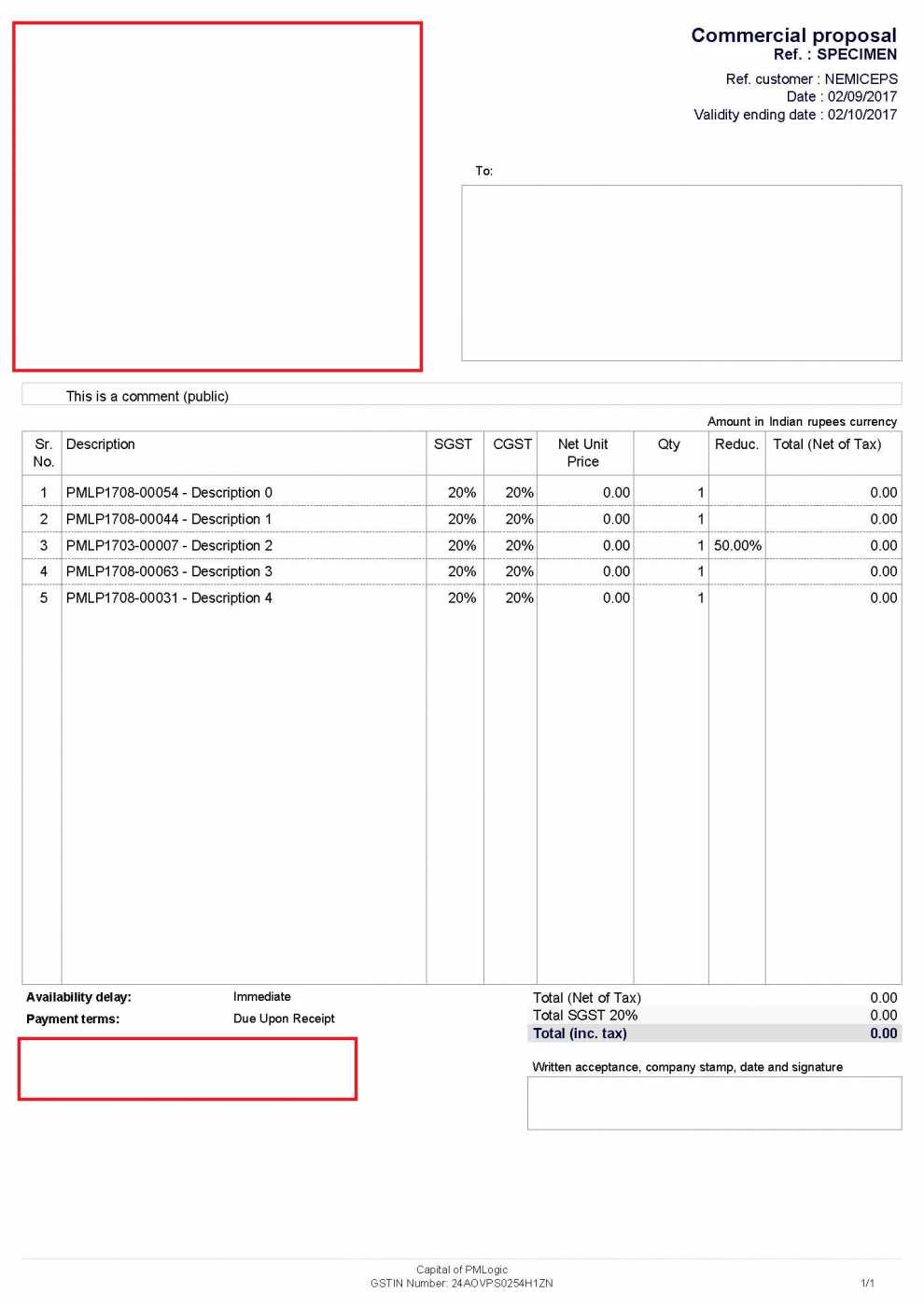

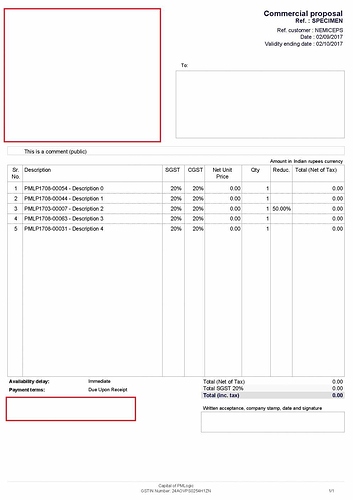

Thank you @Roschi it helped me a lot and able to add Position no. along with my extra fields on my azure template,
I’m trying to get similar output on Sponge template but the above code is giving me ‘Pos. no.’ outside the table without a dedicated column for it
