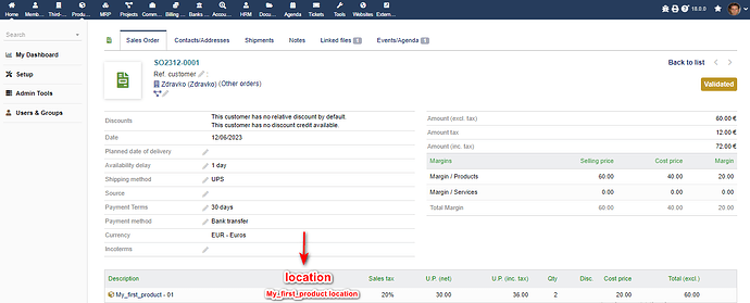

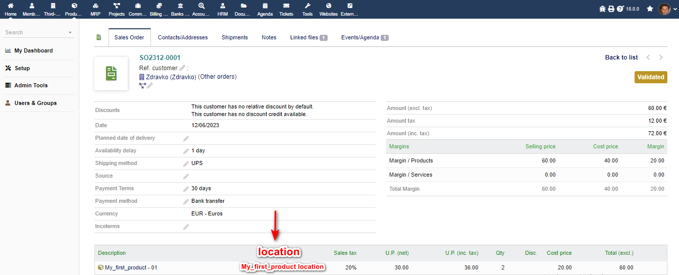

I want to add an additional column in specific table, but I am new to dolibarr and I can not handle it by myself. Any help is much appreciated.

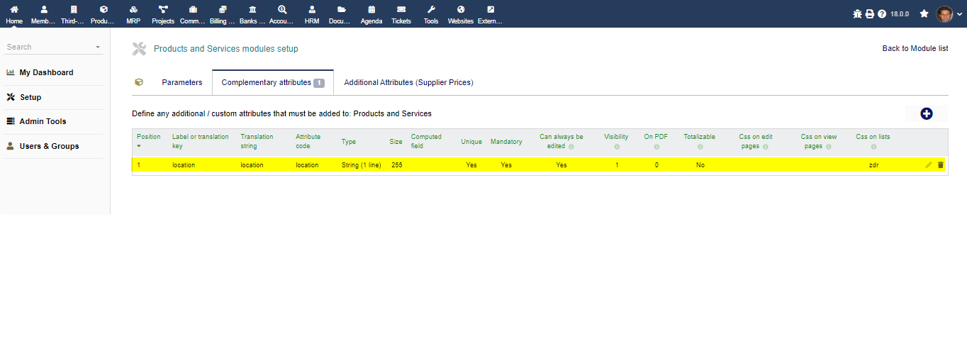

In Products and Services modules setup, I have added Complementary attribute called “location”, which will point the place where each product is stored in my warehouse.
I would like to add an additional column, also called “location” in products list table at Sales Orders section.
The idea is, when I open an order card, to have this additional column with Complementary attribute “location” of each product in the table with all purchased products.
Is it possible to implement this column?
If anyone has a solution to a similar problem, I will be very grateful for sharing the solution.
This is how I would like to insert the additional column

In the product module I created extrafield, called “location”.
When I create or edit product, I enter the value of the “location” extrafield.

Then you need to create :
  • One extrafield on product called location type “String”

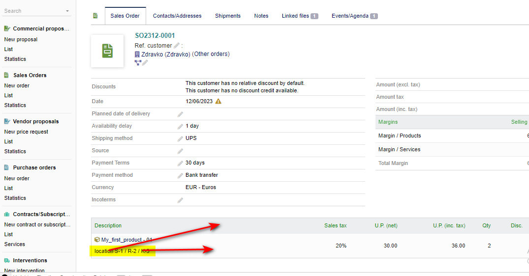

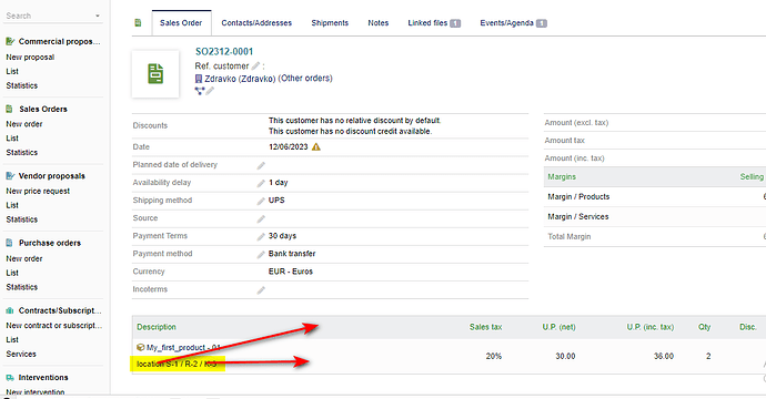

The value of the product’s extrafield “location” now appears below the product’s name, but it should appear in additional column in the table.
Is that possible?
It’s an open source software, so everything is possible !
For this one, I’m afraid not natively
I know one external module that can do it : Dolitools
Or you need to develop your own module.
