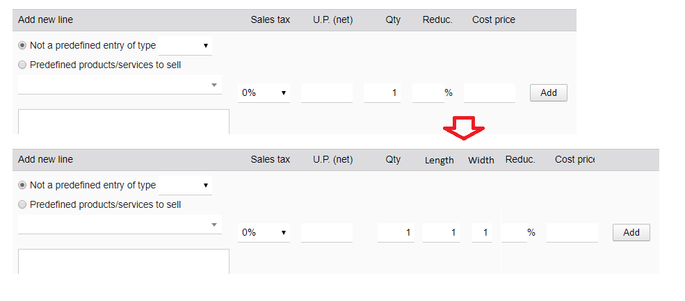

I need to add 2 extra columns (width, height) in the lines of those elements so I can use it for extra information and to calculate the price. Right now I only have the quantity column, but is not enough (sometimes I need 2 products of the same measure) Is there a developer tutorial or something on where and how to add the code?
To give you and idea I add an screenshot.

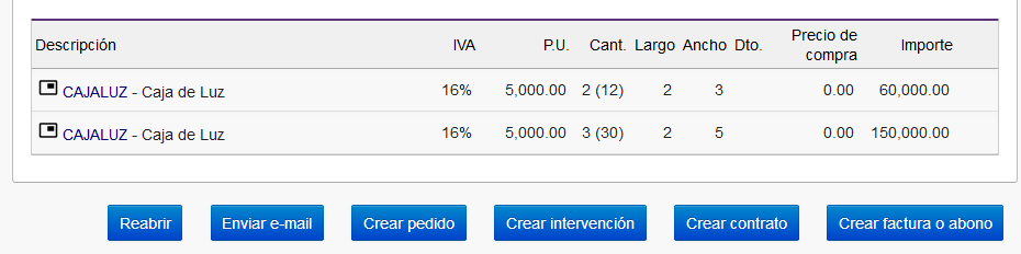

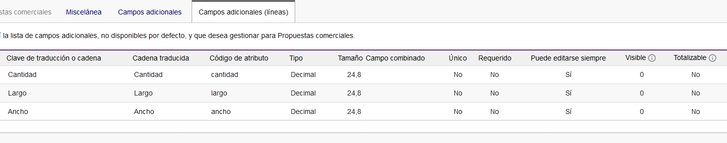

  1. Created 3 not visible extrafields in the lines of proposals, customer orders and invoices: length, width and quantity. The reason that I add my own quantity column is because the “qty” property of each object works to calculate the total price but I need the information separated. Example: 2 (my quantity) sheets of paper of 3(length)x1.5(width) mts will give me 9 “qty” in reality.

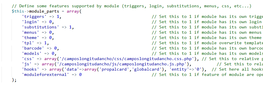

  1. Created my own module using Module Builder (I really encourage to use it) and change the code that I can overwrite templates (tpl = 1), the hooks are used in the context ‘propalcard’ and ‘globalcard’ and removed the menu code (so it does not appear at the top)

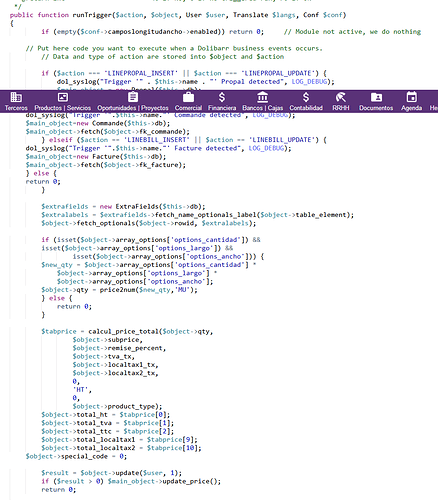

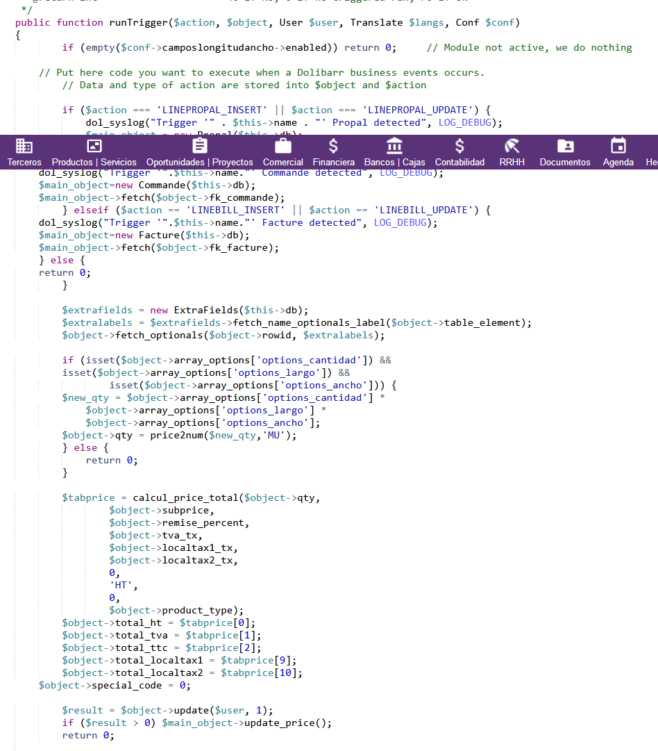

  1. Created the trigger (based in the module that @ksar provided with some extra lines like set $object->special_code = 0 because I don’t use directly the “qty” property of the object, I use my own, and that cause problems displaying values later.

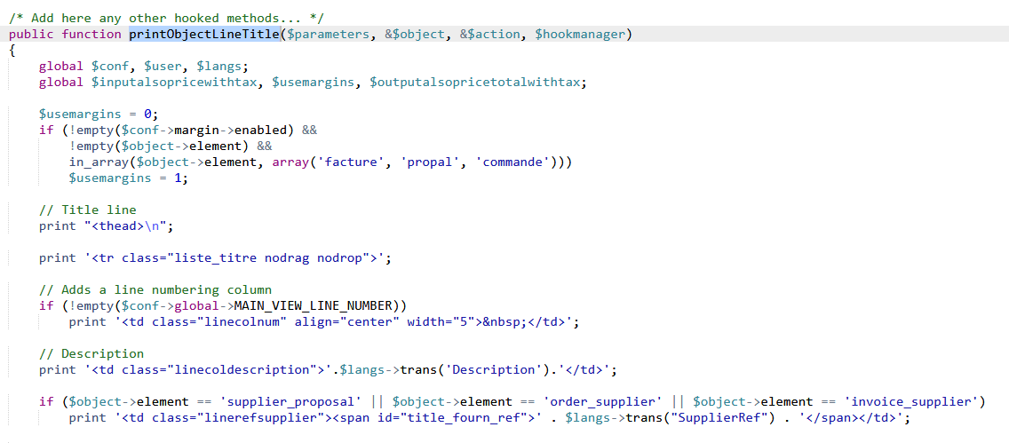

  1. Created a hook for “printObjectLineTitle” because I put the extrafields inside the row of each line (not at the bottom) so I needed to add the columns for my extrafields. I copied the original code, made some changes to add the columns and done with that.

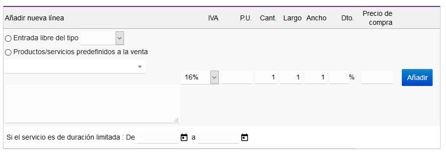

  1. Inside \core\tpl folder of my module I copied 3 files “objectline_create.tpl.php” “objectline_edit.tpl” “objectline_view.tpl.php” that I got from \htdocs\core\tpl folder of Dolibarr. I changed the code so it displays my extrafields (the “qty” field is hidden and given the value=“1” by default to avoid errors in the edit template, the code of the trigger makes the correct calculation later)

These are the results (I keep the qty values between () for clarification:
