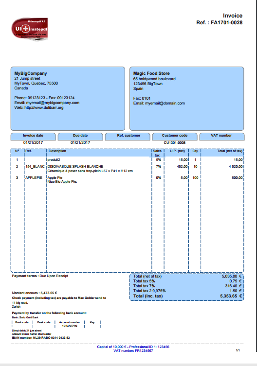

Hi everyone
Ultimatepdf can do the job for all kind of documents.
you can see an example here
Philippe

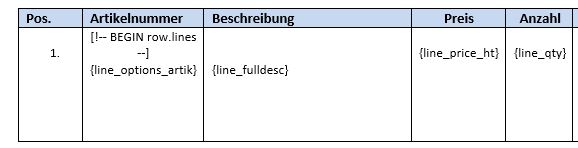

The trick is simple. Just make a column of table to be with Numbering option. For your reference I have attached a image of how I did it. The challenge I faced during the process is the code. Whenever I saved the edited document from libre writer, there was error. So I did editing initially in Word, then copied the calling code from Notepad++ and pasted as shown in Picture.
