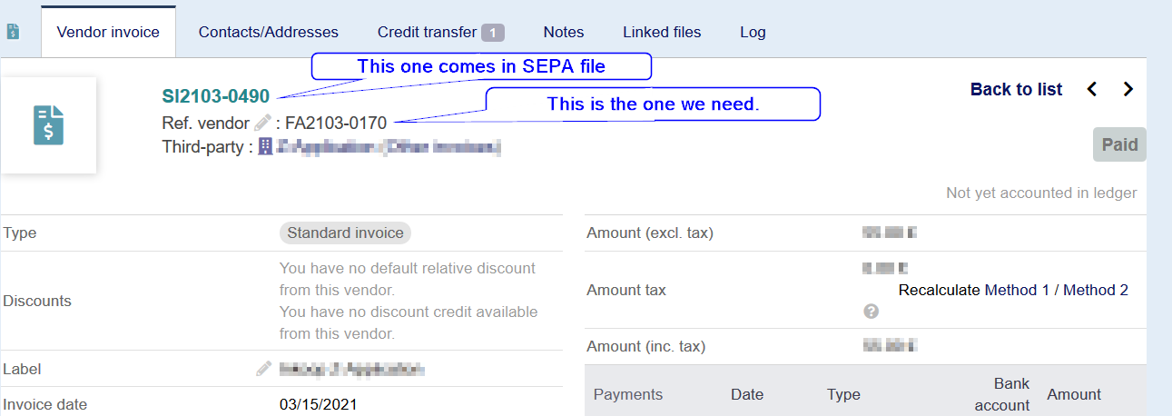

Add vendor reference to SEPA payment xml
Receivers of payments now receive payment with reference. This is the number of administration in Dolibarr.
The receiver can not do anything with it. It needs HIS/HER invoice reference for correct administration!
Is there a way we can add this to de XLM file?

Images says more then words…
Hi Klaas,
Abosolutely true! That makes it clear.
So both fields are stored in the database, but you need in the xml file the reference of the Thirdparty.

I asked because in XML and also when I import it in Bank application in “Remote information” is:
“Internal invoice number” - “Ref. vendor”
example: SI2402-0012 - 5241007522
I need only “Ref. vendor” there.
