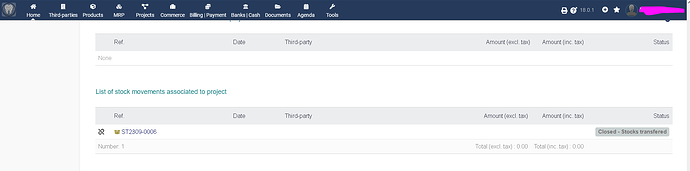

I opened an issue on Github and will try to resolve it, unless there’s something I’m missing here. [BUG] Stock Movement associated with project doesn't show up in Project / Overview window · Issue #26033 · Dolibarr/dolibarr · GitHub

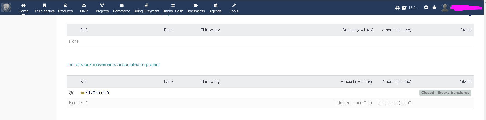

So I’ve got a tentative fix in a pull request up on Github for this, and it properly links the stock movement (and Third Party, if applicable). I would like to adjust the fields displayed to properly reflect what’s important, but it appears that every item in the Project Overview suffers from this, so that’s a larger project for down-the-road.

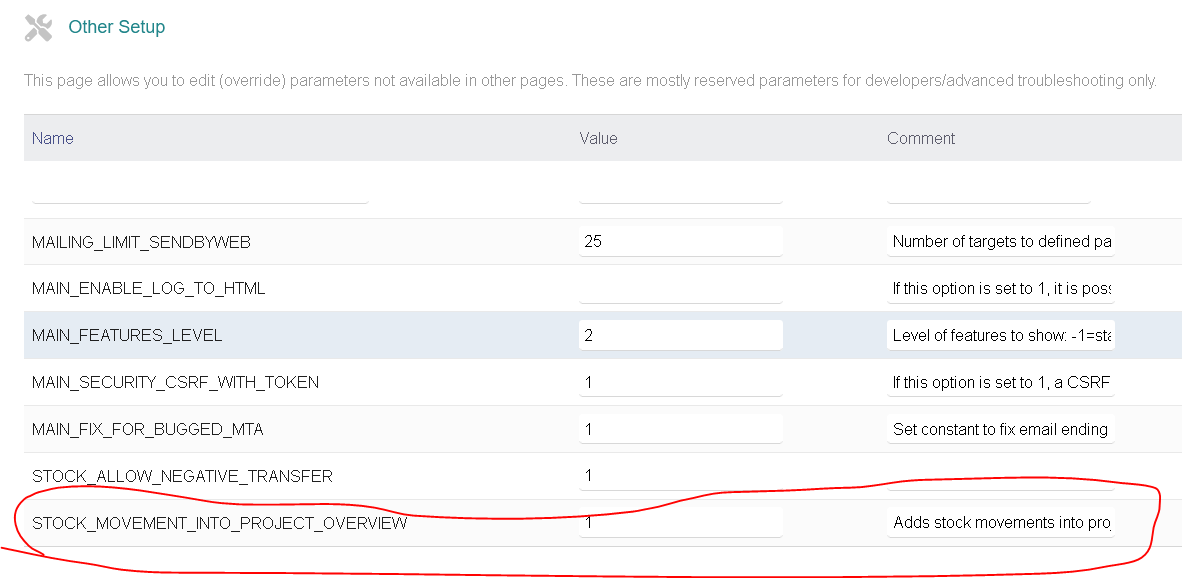

If you do either method, you will still need to set the global config in Other Setup until there’s some more testing and I will in the future try to add the option into the Projects module settings once any possible bugs have been squashed.

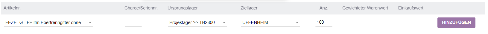

Version 18.0.1 gives me an HTTP ERROR 500 In /product/stock/stocktransfer/stocktransfer_card.php?id=7` as soon as I click on ADD (Hinzufügen)
Version 18.0.2 is the same as 18.0.1 and I have also created an issue on Github: Advanced Stock Transfer: Adding a line causes an HTTP ERROR 500 · Issue #26194 · Dolibarr/dolibarr · GitHub
I have seen that you are also on 18.0.1, so it is probably working. Do you have an idea what could be the issue? Maybe I am missing something, and you can give me a hint into the right direction.
