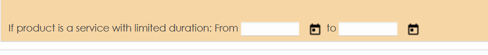

As an alternative, without modifying the pdf, you can add on the invoice lines the period of the services
Nevertheless, you will have to complete this field for each concerned invoice.
