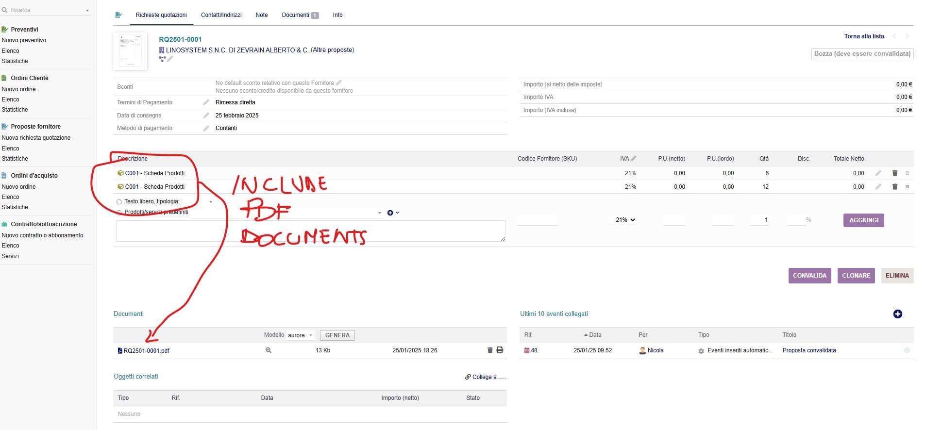

I’m facing a setting problem, I have tried in every way but I do not understand how to solve it.
-When I generate a proposal (or any document) and then send it by email, I would like the documents present in the article registry to be included in the attachments.
Do you think it’s possible to do it?
I attach a screen.
thank you very much

Hi sonikf,
thank you very much for your reply. I agree with you that when I validate my proposal the pdf is generated with all the information.
I would like that together with my proposal pdf the pdfs present in the codes that I selected in the proposal are also attached.
I’ll give you an example:
when I send the email to the supplier, the document RQ2501-002.pdf is generated and attached. I would like the attachments C001-Product sheet 148x148.pdf to be there too.
Do you think it can be done somehow?
thank you very much
I do not think it’s possible with the core, but external module like E-mail atttachments can do it.
