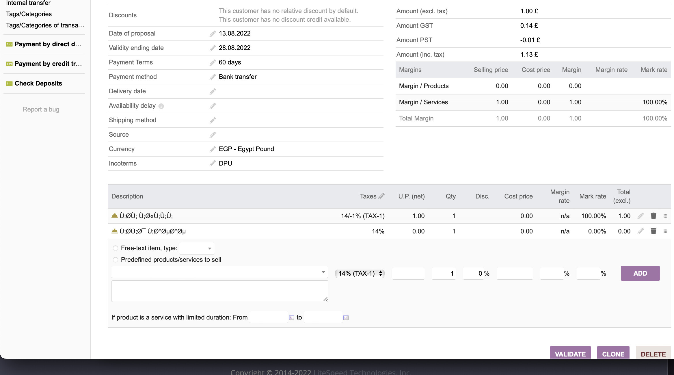

After upgrading to 15.03 arabic character unrecognized
Arabic input after saving turn to unrecognized characters after updating from 15.02 to 15.03 (attached)
is the same time arabic could be read in menu, pdf and old entries
now arabic cannot be used for input in tables (invoice table and every table anywhere) but could read in inventory and headings

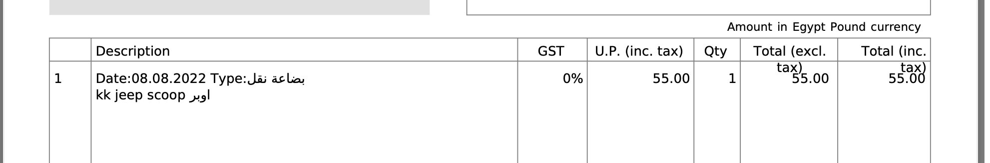

attached old expense report before this happenned you can see arabic with english without problem

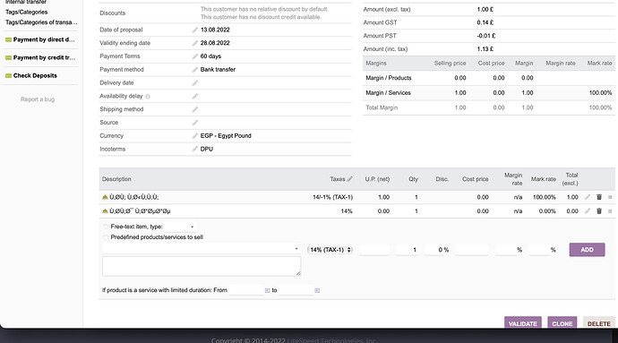

i test input input in arabic with arabic digit in digit table to have normal error message from dolibarr which not accept numeric in arabic the arabic text changed immediately to unrecognized without saving, so somthing wrong with temporary buffer before applying data to mariadb

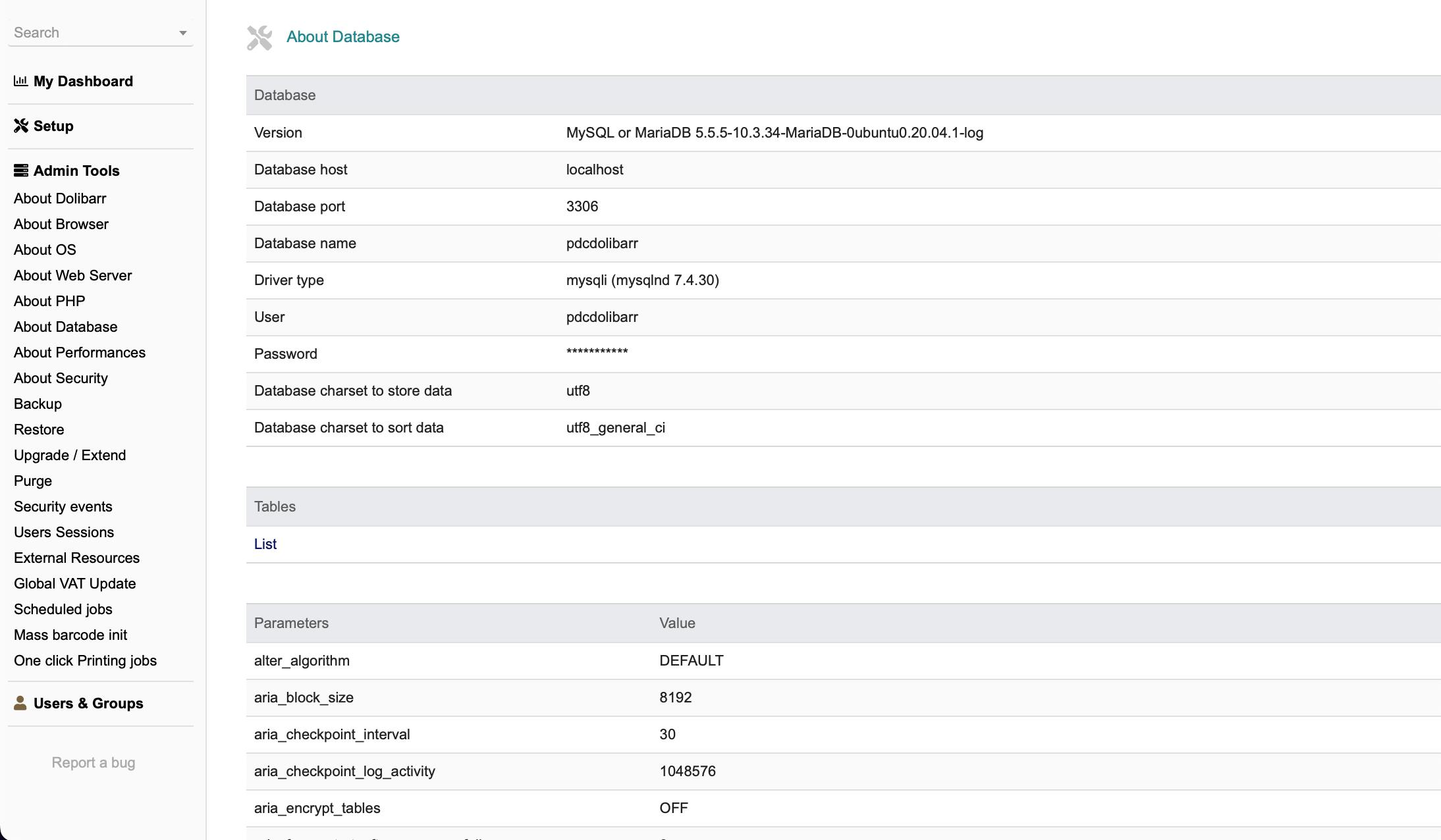

Can you go into menu Home - Admin tools - About Database. Can you provide a screenshot.
Then click on link “List” to show list of tables with their page code. Can you provide a screenshot ?
finally i found the problem
MAIN_RESTRICTHTML_ONLY_VALID_HTML
when add this variable to other setup with value 0 its change arabic to ;;;;;;; and for value 1 its change arabic to the shape in the photo above in the topic
when clear the value and delete it arabic return normal
