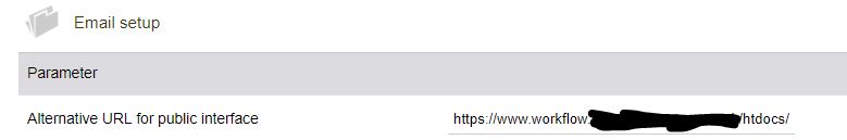

I’m also trying to get this working. Actually, I don’t really understand what the setting “Alternative URL for public interface” in Dolibarr actually does?
I can configure this solely in apache with a ServerAlias so that I could access the portal at https://ticket.domain.com/public/ticket/index.php instead of https://dolibarr.domain.com/public/ticket/index.php. But what I really want is to access the portal at https://ticket.domain.com.
So, I assume that’s what “Alternative URL for public interface” is for, but how does that work? Are there settings to be done in apache conf?
