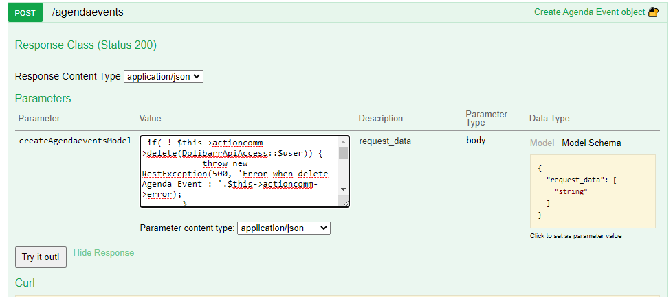

However, when I try to add an event with the API (POST /agendaevents) it’s not working. For example :

I created this example with an existing event thanks to (GET /agendaevents). Unfortunalty, Response Body is always “no content” and Response Code is always 500. I never received another error code with agendaevents.

It was a bug. It is now solved. https://github.com/Dolibarr/dolibarr/pull/6883
