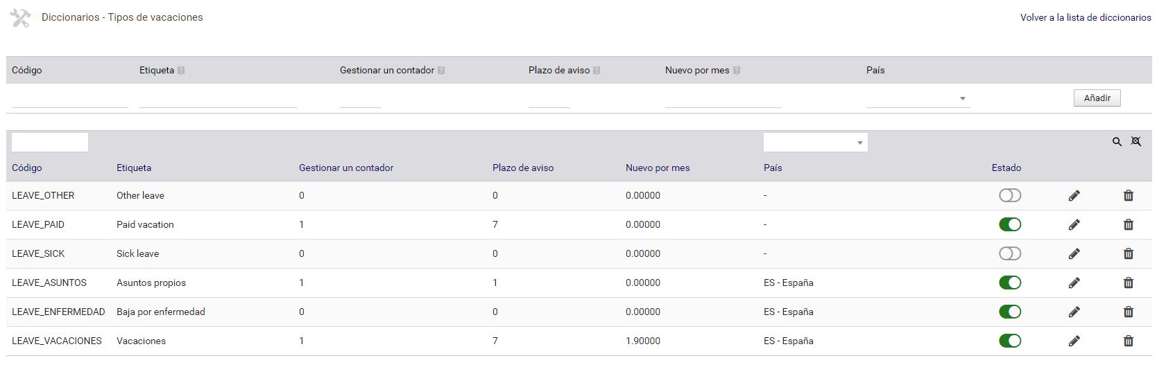

I’ve just updated to Dolibarr 9 and I still have the problem with the balance of remaining holidays. Each month increase with new days but when I approve new days doesn’t automatically decrease. I have to update manually. Any solution? I’ve try with leave_paid type and a custom type.
DOLIBARR ENVIRONMENT
Can you provide a screenshot of the setup of your leave types into home setup dictionary ?
Of course, I send you a screenshot
Pièces jointes :
- Leaves.jpg (60.9 KB)
And what is the type of the leave request done and you expect to see a decrease ?
Only leave request with a type with column is 1 in first column.
On my side, i do not experience any trouble. Decrease is correct on approval as long as the type of leave request was set up for automatic decrease.

I expect to see a decrease in LEAVE_PAID or LEAVE_VACACIONES. Where can I configure a leave request to automatic decrease?
According to your screenshot, they are already setup for this (value is 1 in first column).

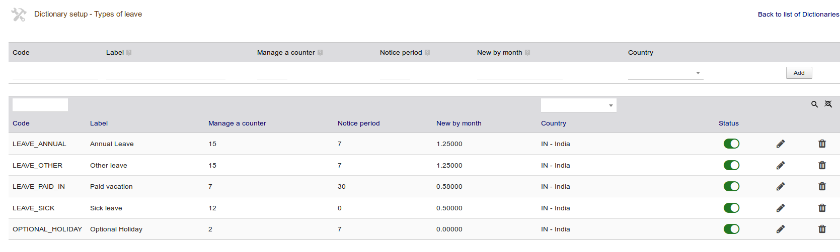

Hi Eldy ,
I upgraded the version to 9.0.1 - latest version and balance of leave is still not working .
can you please help ?
is there any workaround to show the correct balance of leave ?
Attached is the screenshot of setup - dictionary setup -- type of leave .
