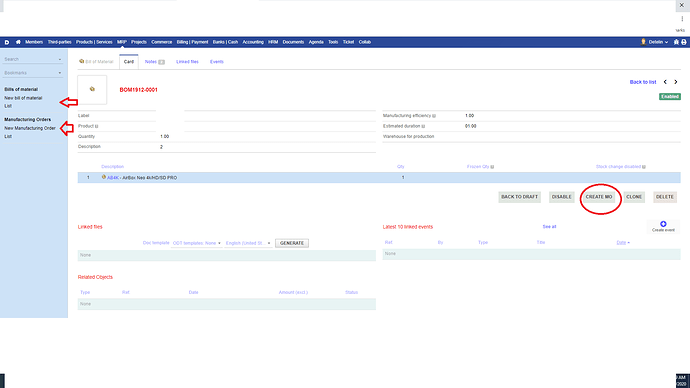

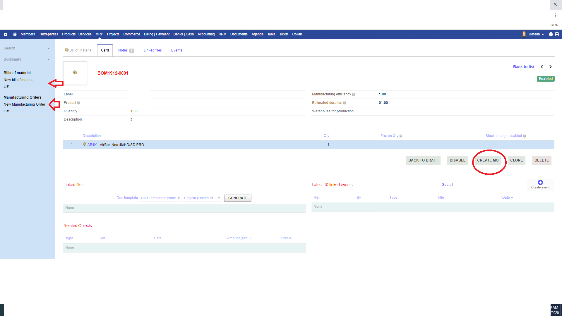

If you did not see Create MO, I guess you did not validated BOM.
Steps are as follows:
  1. Create BOM
  2. Validate
  3. And now Create MO button should be available
    see uploaded screenshots

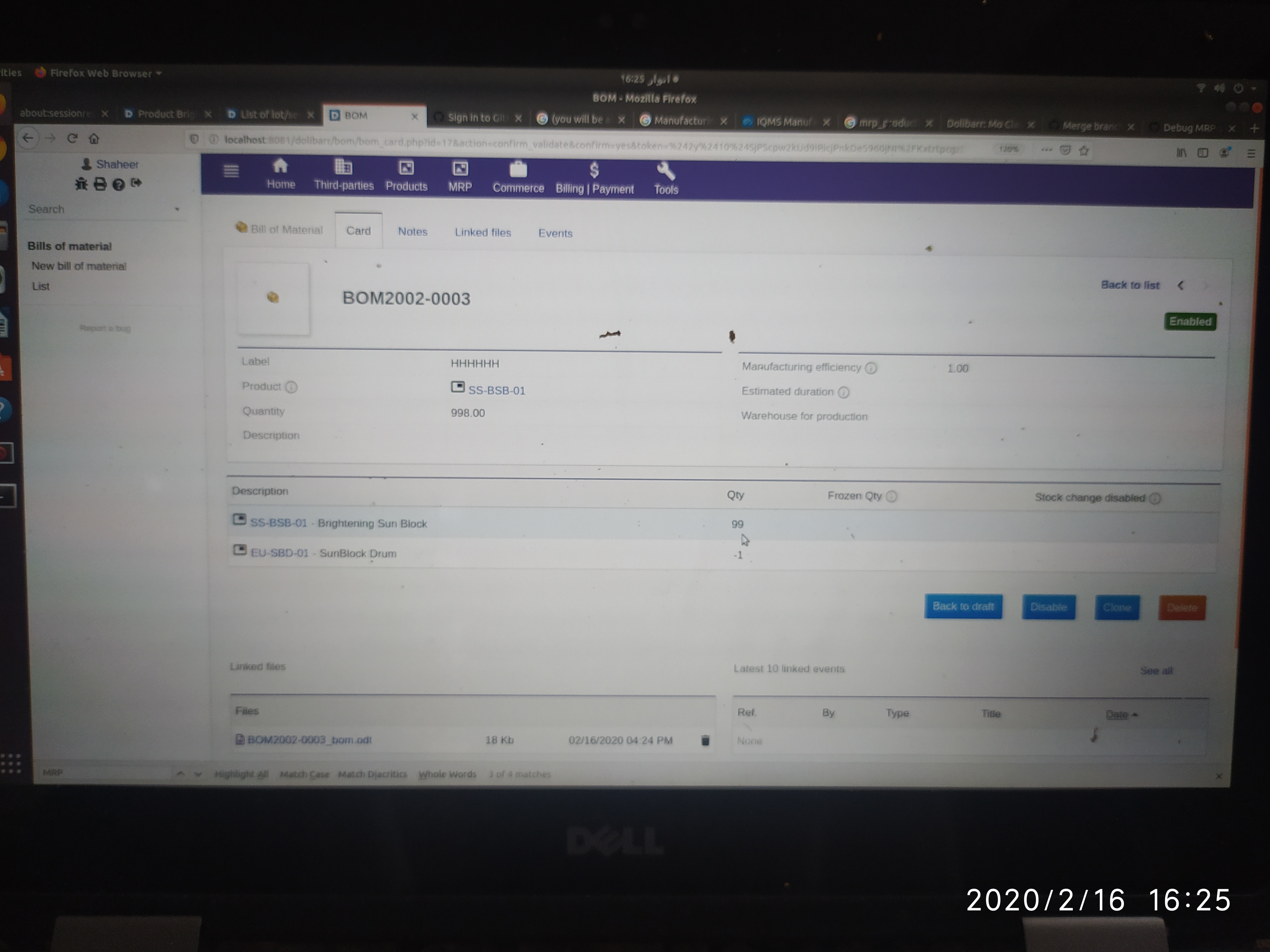

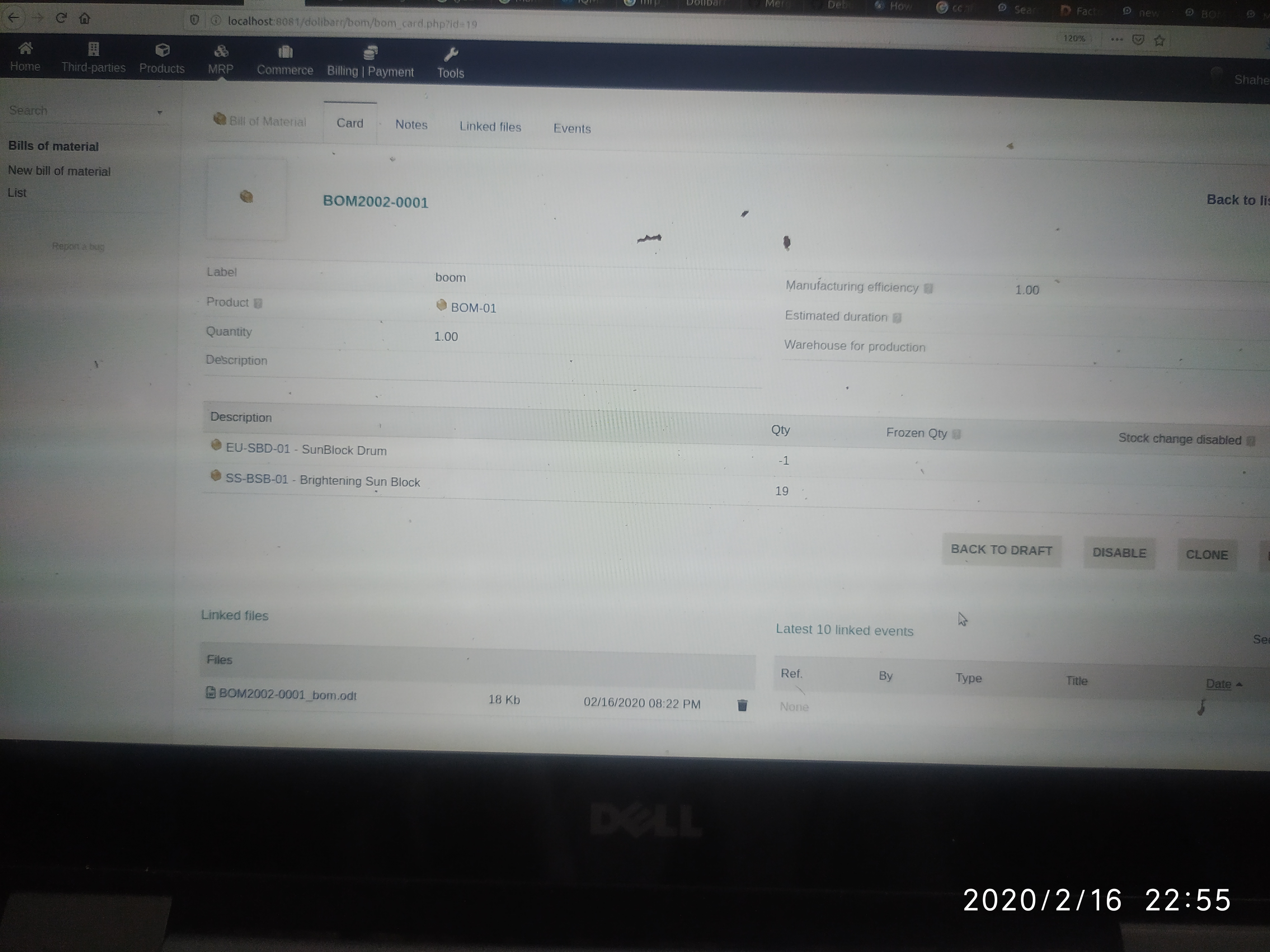

I switched to the other theme that came with Version 11. However I have changed it back as per your suggestion. Though I still can’t see the options. See attached screenshot.
I will list out the steps of what I did . Maybe there something that I might have missed. It will be great if someone can identify a issue in my approach.
1- create product A (Can be sold;Can’t be purchased)
2- Create Product B (Can not be Sold. ; can be purchased)
3- Create Third Party Vendor.
4- Create Purchase order >validate PO.> Create Shippment to Warehouse
5- Create Product BOM-01( Can’t be Purchased; Can’t be Sold)
6- Did not link BOM to Product A and B since negative Quantity are ignored now
7- Create BOM 01( selected BOM)
8- added Product B (-1.00 Qty) and Product A(100) in BOm
9- Validated BOM.
Thanks
Regards
Shaheer
MO module must be enabled (in Modules/Application).
As MO module is an experimental module, to enable MO module, you need to change “MAIN_FEATURES_LEVEL” (in Other Setup) to 1.

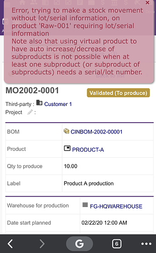

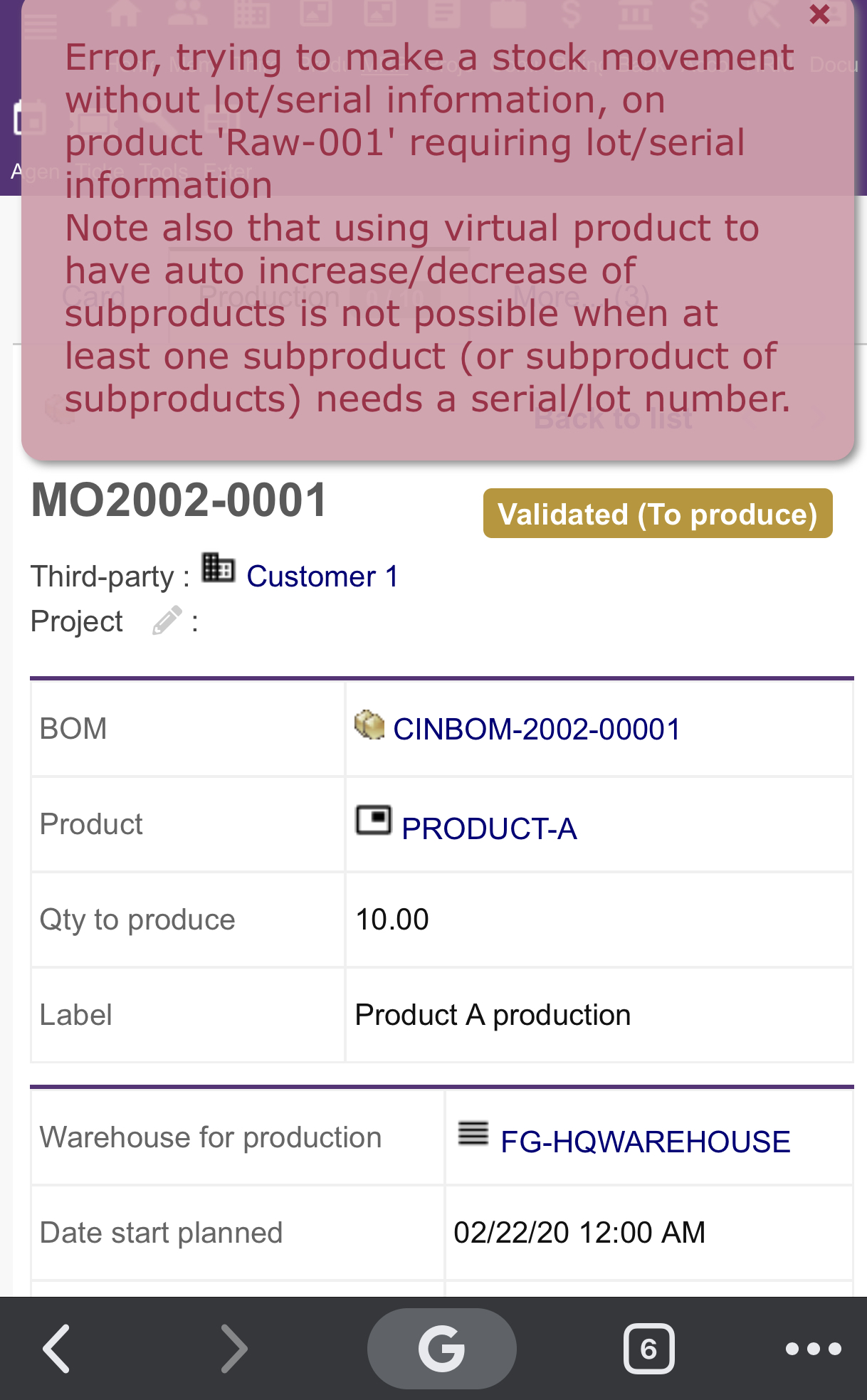

In the production tab, consumption and production requires the lot numbers, How to make this function work since I don’t see the area where I can input the lot numbers for raw materials?
Never mind, sorry, I forgot to activate the lot numbers under products. However, I still get that error info about the lot even though I put the correct lot or serial number.
