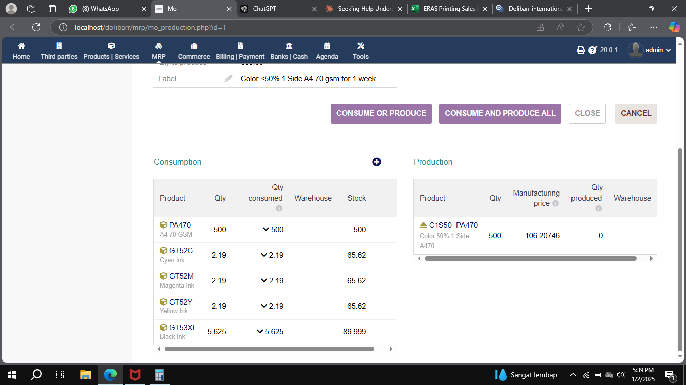

I’ve created a BOM for my printing service, but I’m having trouble with the Manufacturing Order (MO). When I set up the consumption of materials (ink and paper) according to the service quantity I need, the consumption part works fine like in this picture.

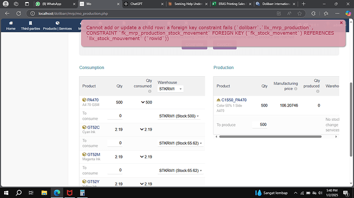

However, I get an error during the production phase (see attached image).
I watched several YouTube tutorials about the production process, but I still can’t get it to work. Could someone please explain what I might be doing wrong or if there’s a different approach I should take for service-based businesses?

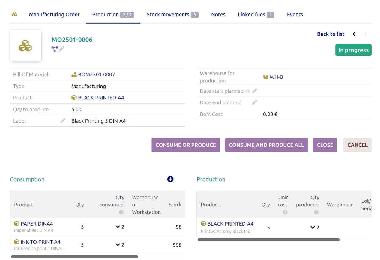

I could do it without errors, but defining the “printing service as a product”:
  1. I created products to be consumed: DIN-A4 paper sheets and Black-Ink (to be consumed by each sheet printed)
  2. I created creadted to be produced: BLACK-PRINTED-A4 (note: it’s very important that you specify in the product cards the “nature” of the products: “raw material” vs. “manufactured”)
  3. I created a BOM to produce the BLACK-PRINTED-A4
  4. I created a MO to “print 5 sheets” with that BoM
  5. And then i proceeded producing 2 of the 5 units
All worked fine.
I think that by now it’s not possible to create a BoM for a service.
Thank you for your help! When I read your reply, I immediately changed it to a product instead of a service, and it worked. I even forgot to reply to your solution. Thanks a lot.
