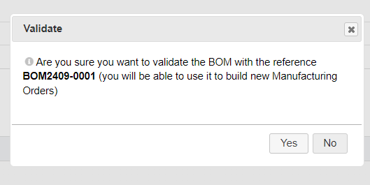

BOM Manually insert reference number
Is there a way to manually insert the BOM’s reference number?. When I validate the BOM the system automatically assign a number, but I want it to be a custom number.
I know that in the BOM module I can set up customs reference number but I have differents choices depending on what kind of BOM I’m creating, so it cannot work.
