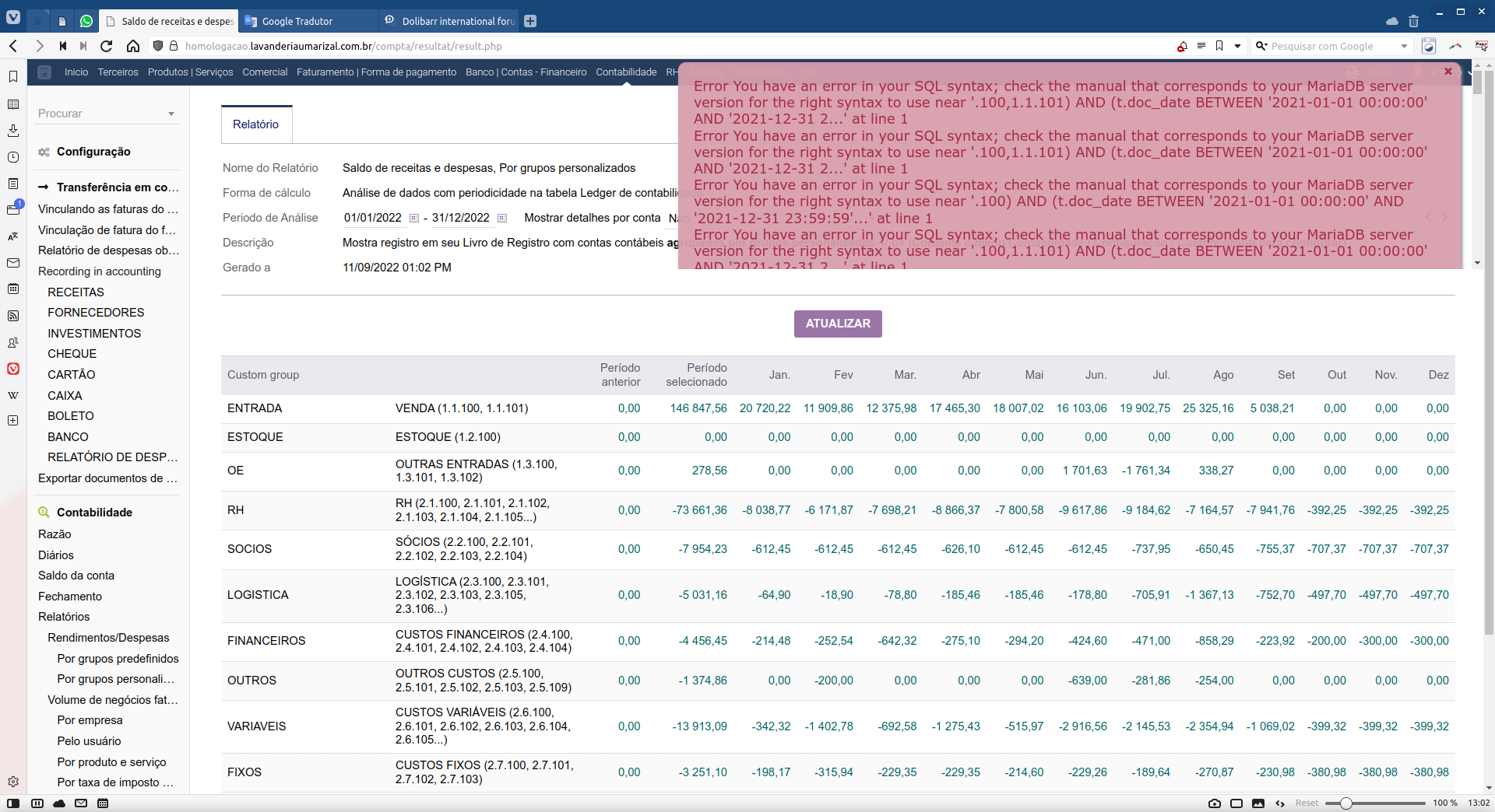

Greetings everyone!
I have an error in the “Custom Groups” section
Error page link: https://homologacao.lavanderiaumarizal.com.br/compta/resultat/result.php?leftmenu=accountancy_report
I can’t create a formula-based group for calculating groups. The system does not perform the calculation.
I created all the groups, and the following error appears:
It seems to me that it is something related to the database. Probably some insertion in the Bank that is giving the bug.
Here is the error displayed in SQL:
Error You have an error in your SQL syntax; check the manual that corresponds to your MariaDB server version for the right syntax to use near '.100,1.1.101) AND (t.doc_date BETWEEN ‘2021-01-01 00:00:00’ AND ‘2021-12-31 2…’ at line 1

Whenever I add a new “Custom Group” it increases one line in the error.
Can anyone help me fix this please?

Dolibarr 16.0.0
OS Linux Ubuntu 14.04
Nginx/1.22.0
PHP 7.4.30
MariaDB 5.5.5-10.5.17
Charset utf8_general_ci
I also have the same issue.
The debug bar show this error message:
SELECT SUM(t.debit) as debit, SUM(t.credit) as credit, t.numero_compte as accountancy_account FROM rpllx8l_accounting_bookkeeping as t WHERE t.entity = 1 AND t.numero_compte IN (4-000-) AND (t.doc_date BETWEEN '2021-01-01 00:00:00' AND '2021-12-31 23:59:59') GROUP BY t.numero_compte 0.4
[DB_ERROR_SYNTAX] You have an error in your SQL syntax; check the manual that corresponds to your MariaDB server version for the right syntax to use near ‘) AND (t.doc_date BETWEEN ‘2021-01-01 00:00:00’ AND ‘2021-12-31 23:59:59’) GR…’ at line 1
But after removed “Parent Account” from List of accounts in custom group menu, the message gone.
This bug happens because the account number is interpreted as a number, which fails at special characters like hyphens - or more than one decimal point. Needs to be treated as a string.
See also issue #22294 on GitHub : Bug: Income and expense balance, By custom groups · Issue #22294 · Dolibarr/dolibarr · GitHub
