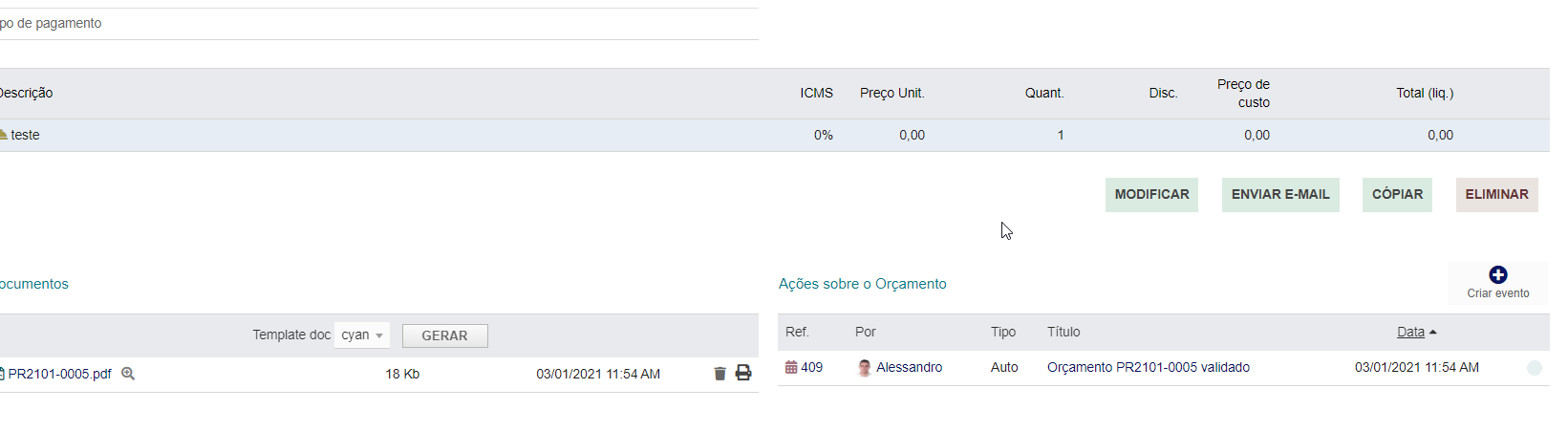

I have a problem with my Dolibarr 12.0.3 in which when creating a proposal after confirming it, the button to classify it as accepted or declined does not appear
This button should appear between the send email button and copy
This button should appear between the send email and copy button, but the first picture does not show my problem, the second shows how it should be
Are you using Advanced permissions? Check if “close” propal permission is enabled
Thanks for answering !
Where is this advanced configuration? I searched for all the modules and didn’t find them, I enabled several options but I didn’t find that option.
Home->Setup->Security->Use the advanced permissions of some modules
Thank you !
I changed so many options to improve security that I did not pay attention to this option, but now it is solved.
