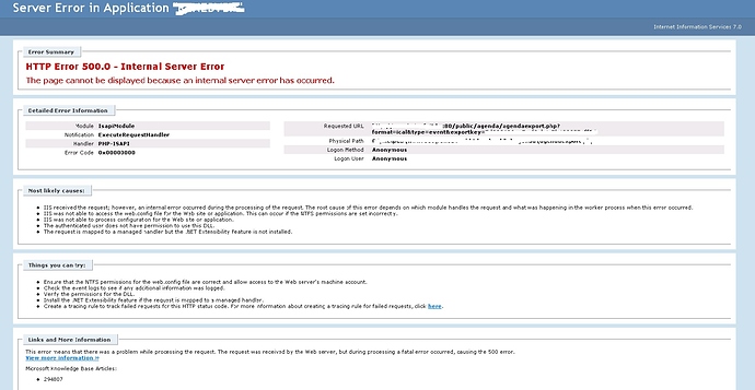

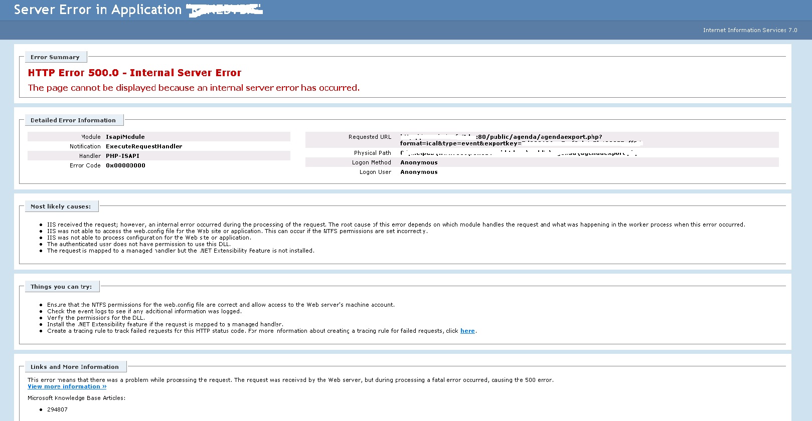

What do you get when you call the vcal export link from browser ? (1st and second time) ?
See screenshot attached … Dolibarr works fine. And once again, this only happens from de 2nd time i try. Also, if i try a few days later it works again for 1 time.
Remember it’s a W8K machine and if I manually delete the files it works for 1 time again.

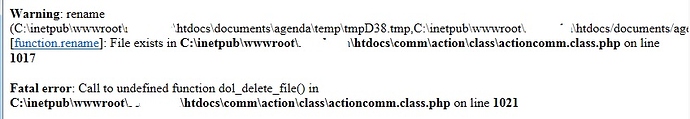

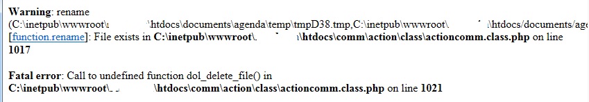

I think the export calendar script is throwing an error because the export still exists. It doesn’t seem to be able the existing export file.
Attached the image with more detailed error

Check into your directory documents/agenda that web server has permissions to write.
Remove also all files into “temp” dir or called “tmp”
eldy
September 1, 2013, 5:46pm
10
removing the entire contents of the temp dir, makes is work for 1 time.
Permissions are ok for the php. the function doesn’t seem to be able to delete the file for some reason.
