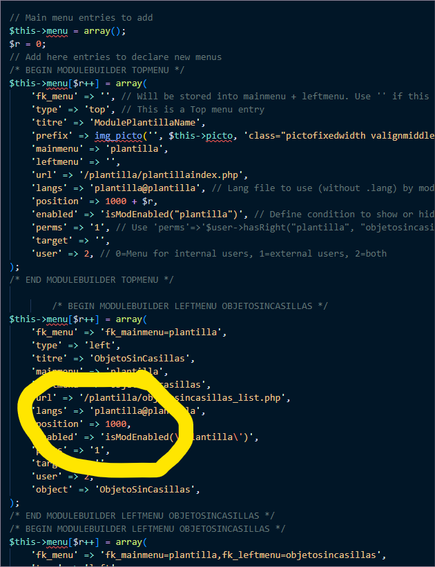

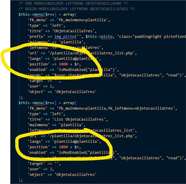

Using v21.0.2.
The problem I found is that the menus of the first object of a module are created without increasing the position, and that violates the unique key enforced programatically (not a constraint in DB):
where ‘position’ => 1000,
should be ‘position’ => 1000 + $r,
From the second object onwards, the menus are created correctly.
I am naive in Dolibarr, not sure if this is the cause of your missing left menu and I do not know where to patch this for future versions. I just fixed those lines manually and activate the module.
