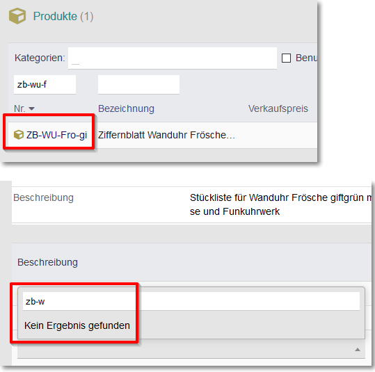

a strange problem occured the last day:
we assemble clocks. For that i created different BOMs for different clocks. So far no problem. But now i tried to create a new BOM (the 11th), and suddenly i can add the basic clock, but not one more part. It is simply not shown in the pull down list of the line.
At first i thought i had made a mistake with the prodct (raw material), but i copied it from a similar product (as i did before with other raw materials). I then created it completely new (without copying an existent product). But whatever i did, the raw metarial wasn’t shown in the pull down list.
I tried to find the parameters of the bom-card in the php code. But wasn’t successful.
btw: the raw material was shown in the list of products. So i’m sure it is created correctly. I compared each field of the new raw material with an existing one, which can be used in a BOM. There was no difference.
I use Version 13.0.1.
Does anyone had this problem too in the past ?
and a question to the developer: what is the parameter for the rawmaterial to be shown in the list ?
thanks in advance
Stefan
Here some screenshots:
on the upper one you can see that the raw material is created an is namend “ZB-WU-Fro-gi”
the lower screenshot is made from the BOM. I tried to add a line and therefor filtered for the raw material. But the system told me “Kein Ergebnis gefunden” (means: “no result found”):
