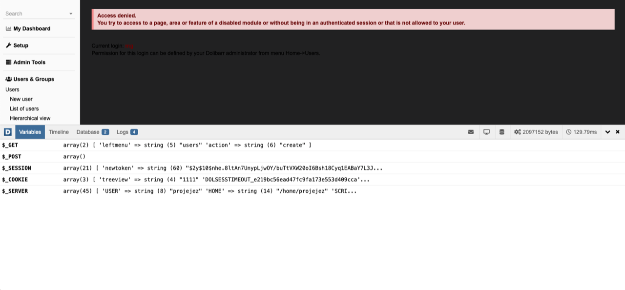

Under Users & Groups, Groups, New group I can’t add a new group. I am getting following failure message:
Current login: mg
Permission for this login can be defined by your Dolibarr administrator from menu Home->Users.

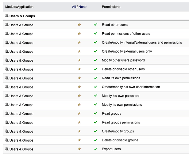

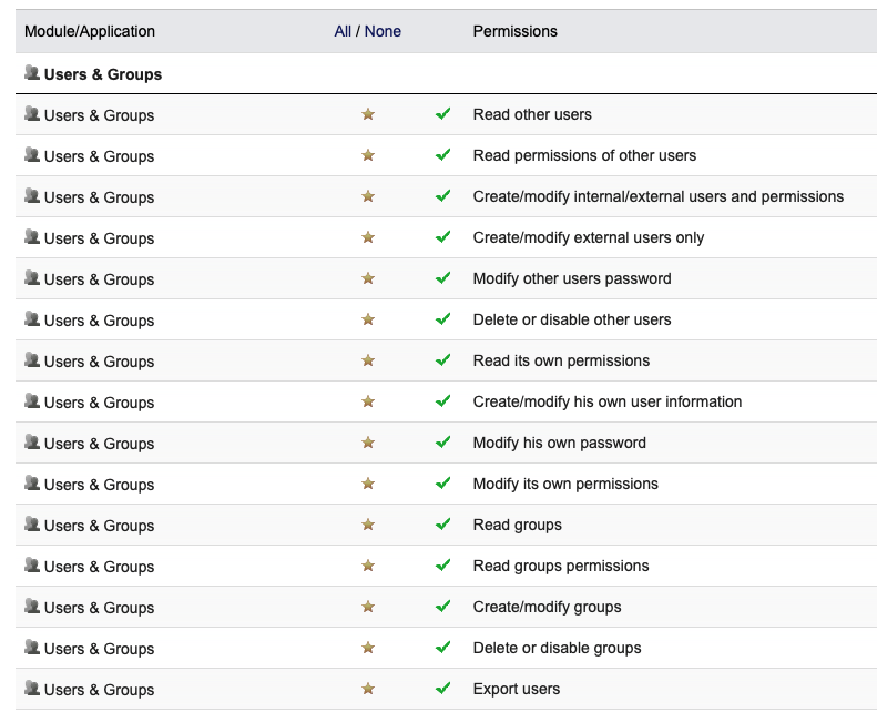

Thank you Marc, please check attached picture of my permissions:
Do you have any external module, such as multicompany ?
No nothing, only started now to setup User/ Products/ Customers/ Vendors …
Sorry, I can’t see what can be wrong. This would need deeper inspection.

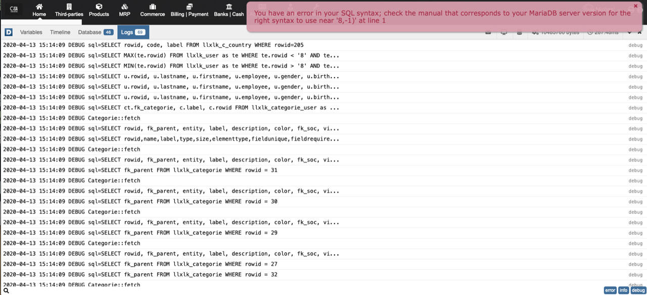

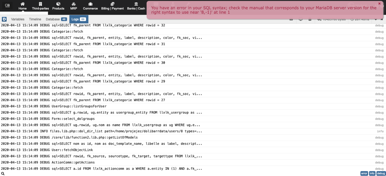

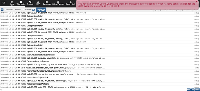

Another failure message if I want Add a Group under User / User card / List of groups for this user
The behaviour is very strange. It looks like you have a problem with the entity definition. Moreover, if you are where I think you are, you should not have a -1 in the sql query (group id). What are these users ? Internal/external ? What exact version of Dolibarr are you running ? Is this a fresh install ? If not, what is the history ?
You have to activate logging if not done already and inspect what the system is doing, notably the sql command sent before this error.
Regards,
Marc
Thanks Michael, problem is lines are truncated in the screenshots and we are missing the one with “INSERT”. Could you provide the full log file ?
