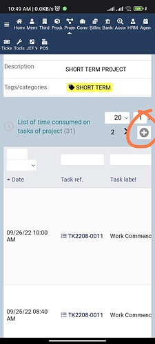

Can someone help, I just upgraded my dolibarr to version 16.0.0 and suddenly I can no longer add time spent on my projects. Please I need your urgent response. Thanks
What does that mean ? error message ? logs ? etc…
@ksar It’s just keeps saying that I don’t have the permission to do this when I hover my mouse around it
The + button turned grey instead of the usual blue colour
Ok, it’s just after the upgrade ?
Check the permissions, if all ok, try to deactivate then activate project module.
@ksar thank you so much. This solved my problems…
I had the same problem. Solved by giving the relevant user permissions. This is a new feature in V16.0
@digiswiss Thanks. I noticed while trying to do apply the fix @ksar suggested.
Another workaround was also to go into Projects and then add the time under the “Time spent” menu on the left. This appeared to not require the same user rights.
@digiswiss this didn’t work when we tried it then
