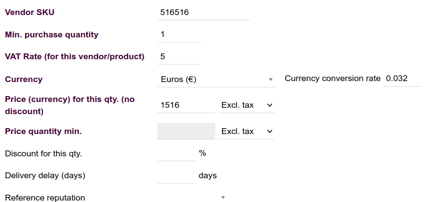

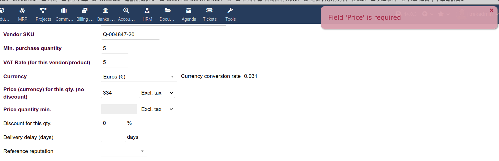

When i try to save the product buying price , it show a error " Field ‘Price’ is required " .
But I have input buying price as below . How do i fix it ?

I think the field “Price quantity min.” is also mandatory. Could you try entering a value there, too?
Hi
I have checked that , but i can’t input value into it .
And i check the other product that i add buying price before , and no " Price quantity min " required .
I was misguided by the label, since it was printed in bold. I tried to save a price in 15.0.1 without problems, but probably your configuration differs from mine.

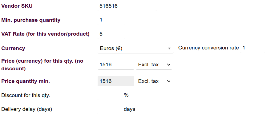

Also , i try to use the other currency all will has this issue , also i found that if i use other currency and exchange rate is not 1 , then " Price quantity min " will not auto caculate . And if the exchange rate is 1 , the " Price quantity min " will auto caculate . Then the error message will not show out .

And i have upgade it to v15.0.1 , the issue is still there .
Also . i have the other dolibarr v15.0.1 on linux host , and it has no problem , too .
And this dolibarr is installed on windows host .
Just a wild guess: May it be linked to the decimal separator in the conversion rate, which is a dot in some countries and a comma in others? Is there any related systems setting on the windows system, database or similar, which may lead to a different interpretation? It sounds like the conversion rate with a dot is not regarded as a valid input, therefore not calculating the min price.
Hi
I think you are correct .
I change the 0.032 to 0,032 , the " Price quantity min " will auto caculate .
But the answer is wrong .
