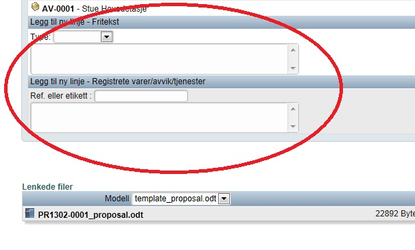

How do I change the size of the text field when I have an item with a lot of text, I see the entire text.
Where the script is the ability to set the size of contents?
Pièces jointes :
I’m afraid there is no option for that.

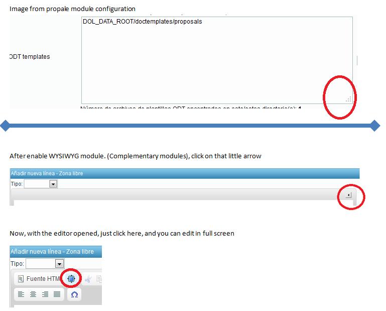

If it could help Knut, when I need to introduce too many texte there, heres is how I do it.(first must enable the complementary module WYSIWYG, look at the attached image with 3 steps).

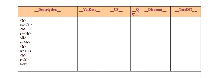

Really dont know, as I always use pdf model, for me is much better to send these pdf directly, instead of create the odt and then, download and generate a pdf for send it by email.
But as seen in the attached image, odt templates doesnt support html text, only plaint text, obiously.

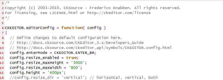

good news Knut, after playing a little with the new template amarok, found where to enable the option to resize the text editor.
This option varies depending witch is the theme you are using, go to the THEME folder in the dOLIBARR root and find your actual theme.
The open the file config.js it is into ckeditor folder, uncomment about line 12 and chage to true, 13 and 14, and adjust the maxHeight and maxWidth values. Not sure if is it neccesary to add ‘’ in these values.
By the way, must say that I test it in Firefox and it works.
This is how it looks after
