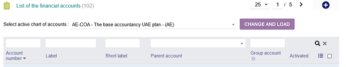

Is there any built in chart of accounts for UAE or India based accounting accounts…?
like : /install/mysql/data/llx_accounting_account_XX.sql where XX is either AE or IN
thanks

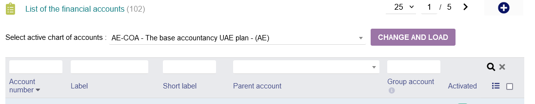

For UAE chart of accounts, please refer to : IFRS - List of IFRS Standards and IFRIC Interpretations
@RiseValInfotech
Have you been implementing the Dolibarr ERP System in the UAE?
Would you mind who is your Auditor/Auditors?
