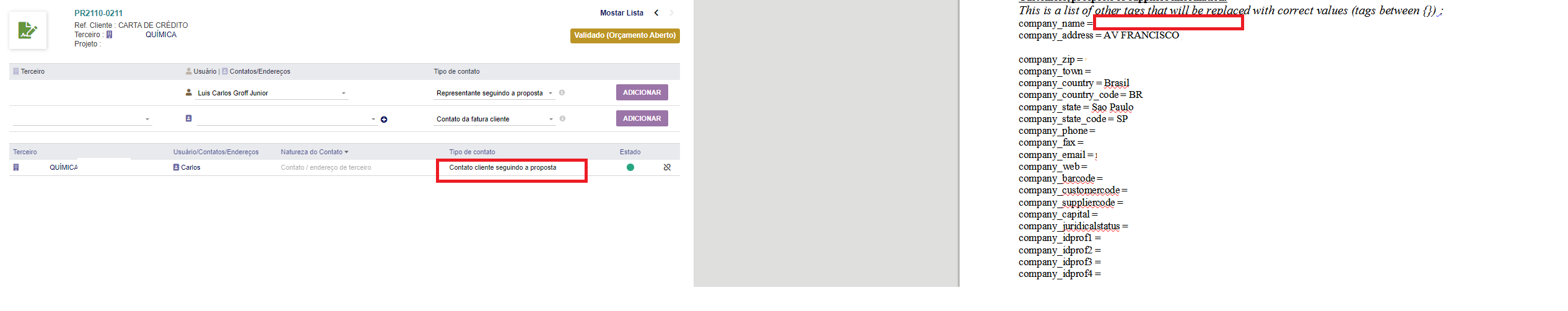

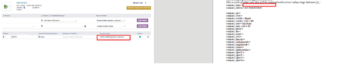

Hi Masters.
We have some problem on exchange some fields on Proposal ODT. When you select Contact on Folow proposals guide, Dolidarr system doesnt exchange the field, see below. But if you dosent select it then system exchange de filed. Somebody help me ?
I think this may be the same as I wrote here: V14.0.0 ODT misses company_name and VAT ID if you have a Billing contact defined - BUG
Looks like you are also not having VAT info in the output.
Does that contact have a default role assigned?
