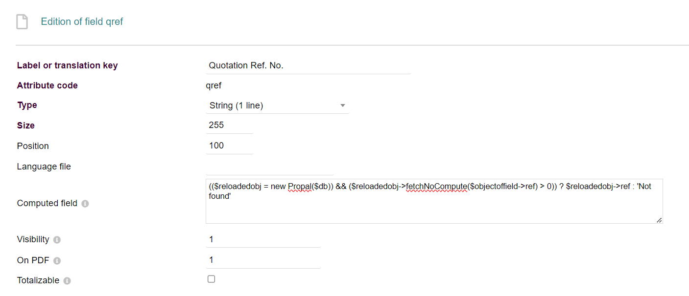

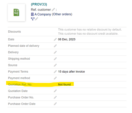

I ran the print_r($objectoffield) and found the reference id as [ref] => TE/CT02/302 (showing the right proposal no as TE/CT02/302 ) then I changed thr code to

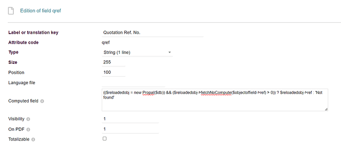

(($reloadedobj = new Propal($db)) && ($reloadedobj->fetchNoCompute($objectoffield->ref) > 0)) ? $reloadedobj->ref : 'Not found'

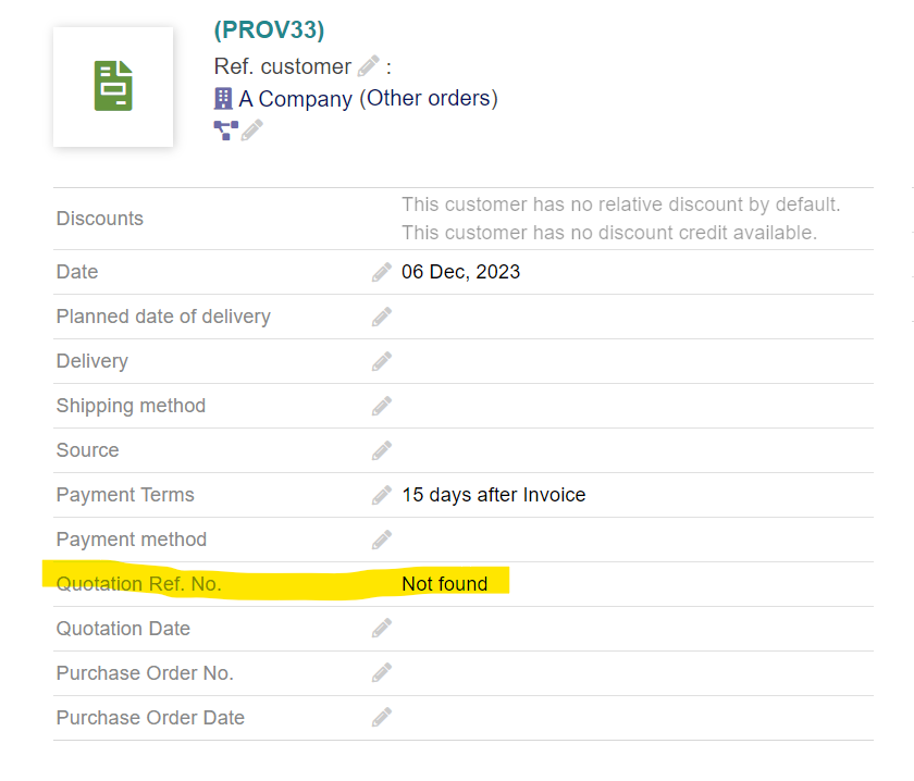

but still getting the Not found in the computed field. attaching images for your reference.
If ref is part of the object, then the formula should be $objectoffield->ref
