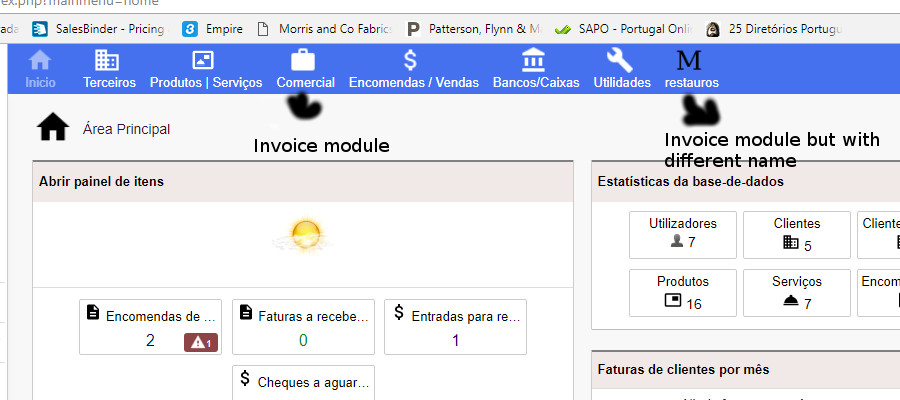

I dont know if i made myself clear but what i would like to have is the following as the image.
In fact i want to have ON the invoice module, but i would like to have another module exactly the same as the parameters of the invoice but with different name ( in image i called Restauros), and the function of this module will be almost the same . For some kind of products i use ( comercial as in image ) that is the module of invoices, and for other kind of products i use the (restauros ).
Can you explain me how to do it ?
Thank you in advance
