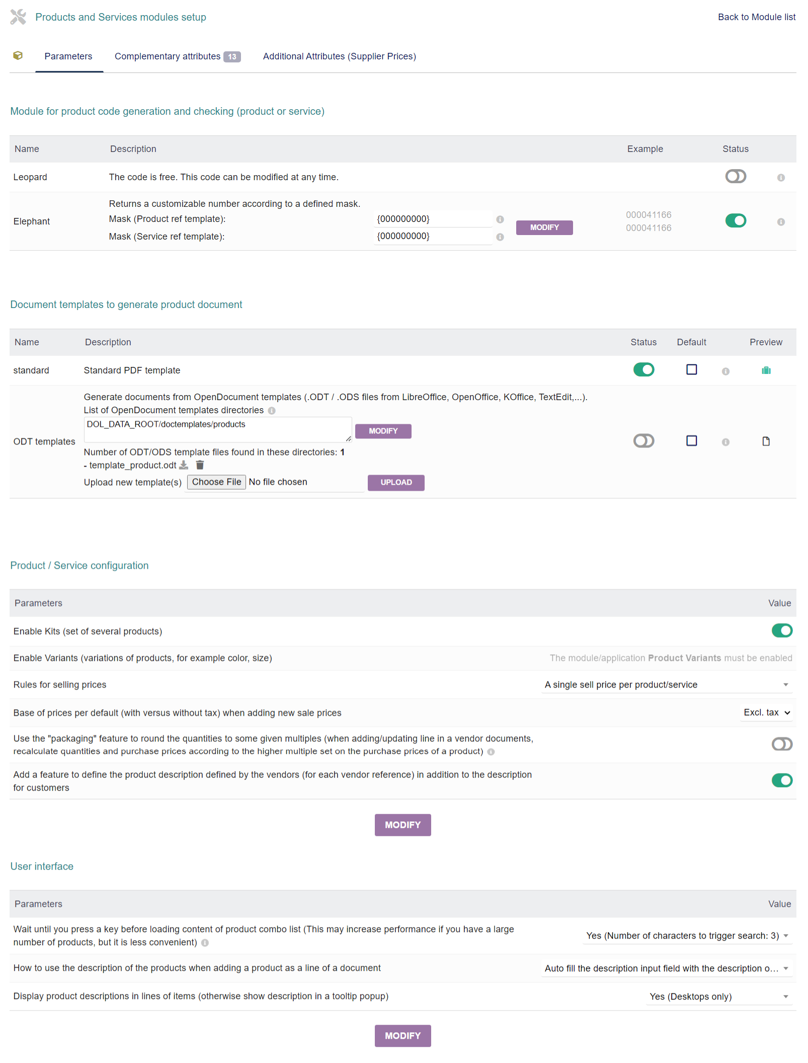

What is the rule for the “numbering of product ref” into setup of module product ?
Hello @eldy
Dolibarr version is 19.02
Numbering “mask” is setup as this: {000000000}
(also, I have attached a screen capture of my module settings)

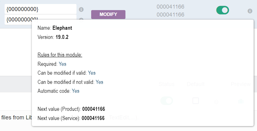

When you put your mouse on the “i” on the line “Elephant”, what do you have ?
Also may be you can try to upgrade to 19.0.3…
“i” message on line “Elephant”:

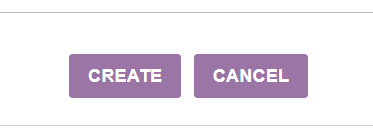

Yes, when I click “CREATE” button nothing happens at all, unless there is a required field empty. If a required field is not filled, then it will prompt to fix it. But other that that, nothing.

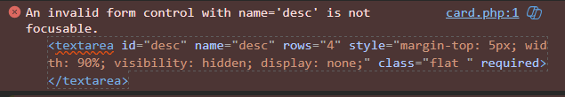

I may have stumbled on another clue. I get this console error in each of my browsers:
An invalid form control with name=‘desc’ is not focusable.
<textarea id="desc" name="desc" rows="4" style="margin-top: 5px; width: 90%; visibility: hidden; display: none;" class="flat " required=""></textarea>

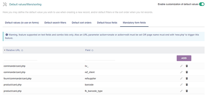

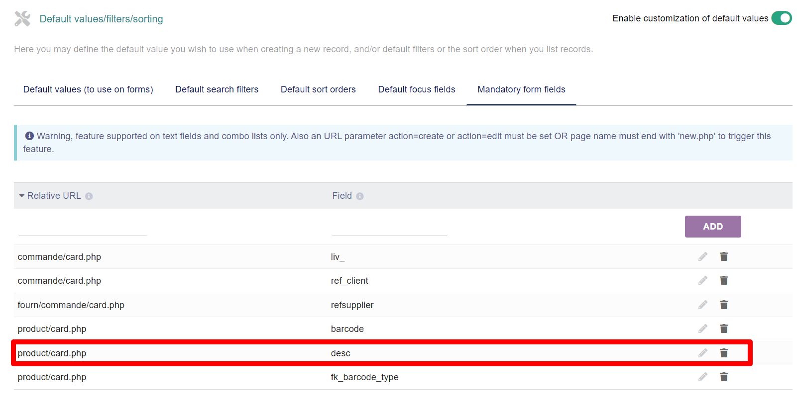

Figured out the problem, but not sure of the real solution (may be a bug)
I had added some “Mandatory form fields” during the late stages of my setup. One of them was “desc” (Description):

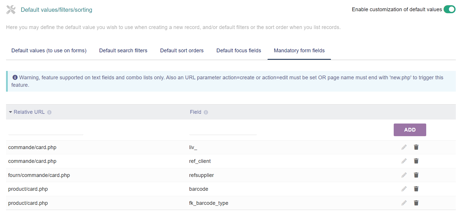

It looks like this caused the issue. As soon as I removed that requirement, “Create” button started adding records correctly again:

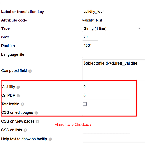

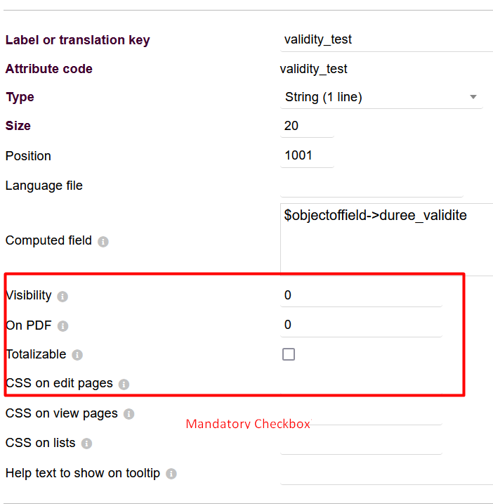

Figured it out!
Somehow I had a Computed Field that was marked as MANDATORY! The problem with that is… that there isn’t an option to unmark it Mandatory:
It probably started out as a simple string, which I then made into a Computed Field (at which point the option to mark as not Mandatory disappeared). That’s a wierd one!
