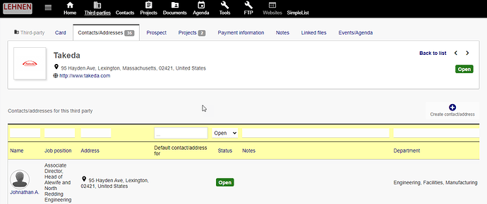

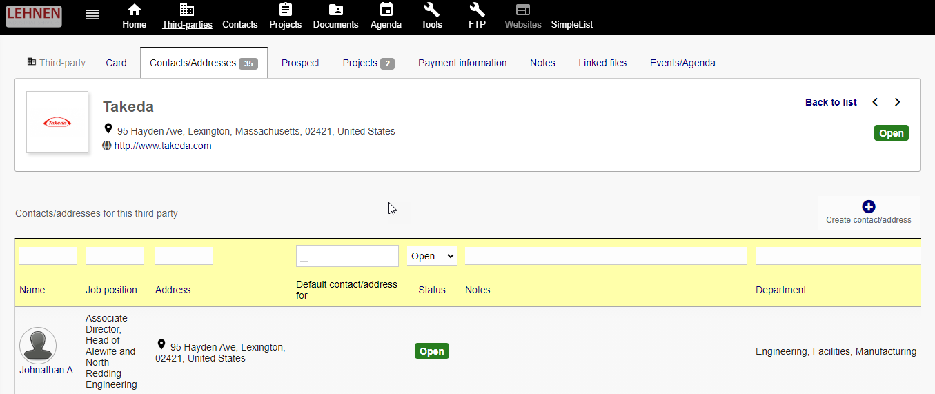

I was hoping to add a list of editable fields under a contact that is attached to a third party: in this example ā€œDepartmentsā€
For example Jonathan A. below is a contact listed under the third party of Takeda.
I’d like to have the Department have a list of pull down items that I can select for each new contact that I create.
I was hoping I could populate 12 or so job titles that would live under ā€œDepartmentā€ so that I don’t have to manually type ā€œEngineering, Facilities, Maintenanceā€ or ā€œProductionā€ it’d be nice to select from a list that I can edit/populate and save. Then simply select which applies and save the changes to that contact record.

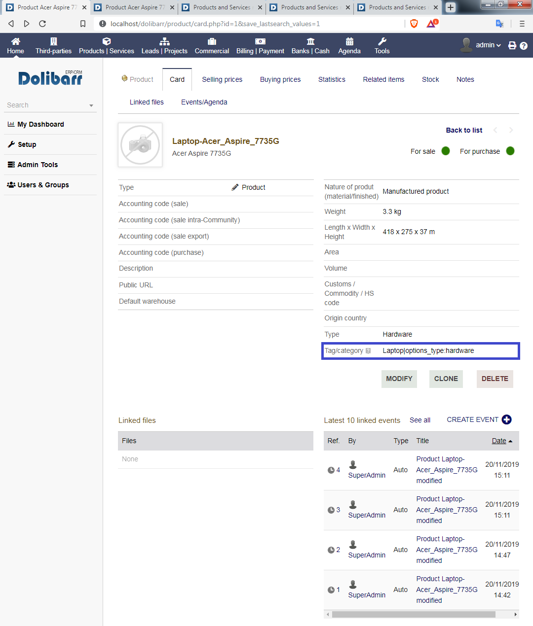

Please try to follow the tooltip when you add an extra complimentary attribute for contact in the setup, modules, third party: List of values must be lines with format key,value (where key can’t be ā€˜0’)
for example:
1,value1
2,value2
code3,value3
In order to have the list depending on another complementary attribute list:
1,value1|options_parent_list_code:parent_key
2,value2|options_parent_list_code:parent_key
In order to have the list depending on another list:
1,value1|parent_list_code:parent_key
2,value2|parent_list_code:parent_key
