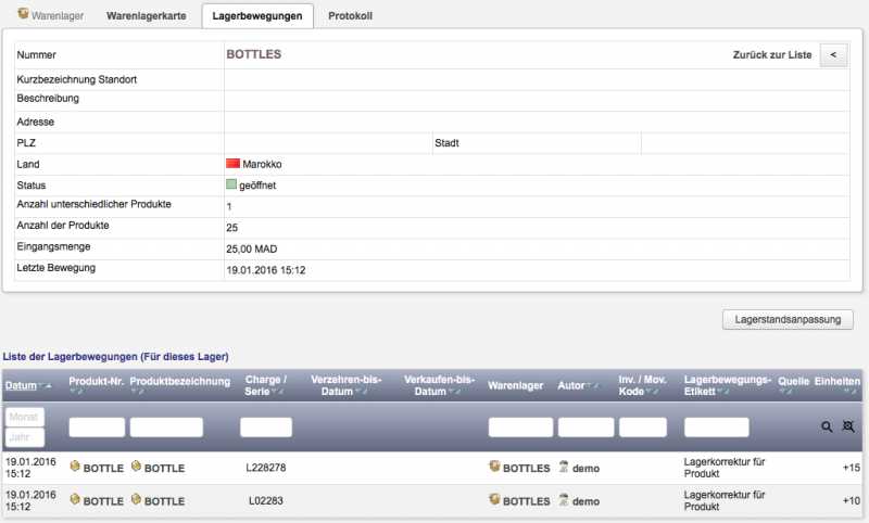

Hi mazzimi!
I don’t use that feature, but it seems that there is nothing special to implement. You can use Dolibarr’s warehouse and serial-number management:
Have a look at the demo at: Dolibarr demo account
The picture upload (tiff) didn’t work… so once again with JPEG:

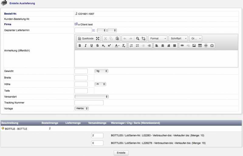

thank you for your answer.
I have upgraded to latest version, and not I can see serial-number/stocks managements.
There is only one last problem, which is unfirtunately stopping for the whole process.
After I have created an order for a customer, I have set it as confirmed and I have confirmed it to be shipped, nothing happens in the stocks.
Unfortunately the warehouse get not unloaded of the number of items of the order, not I get asked of lot or setian number for tjose items.
Everything works perfeclty for incoming products, when I send them to the warehouse, I can enter the lot number and the stock counter gets increased.
It seems to me that stocks automatic unloading is not working when you select “Decrease real stocks on shipping validation”.
