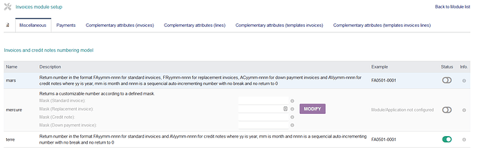

How to make custom invoice number and custom number for bills? Is there any module for this or how to do this?
Can anybody help me? I use Dolibarr v15.
Thank you very much.

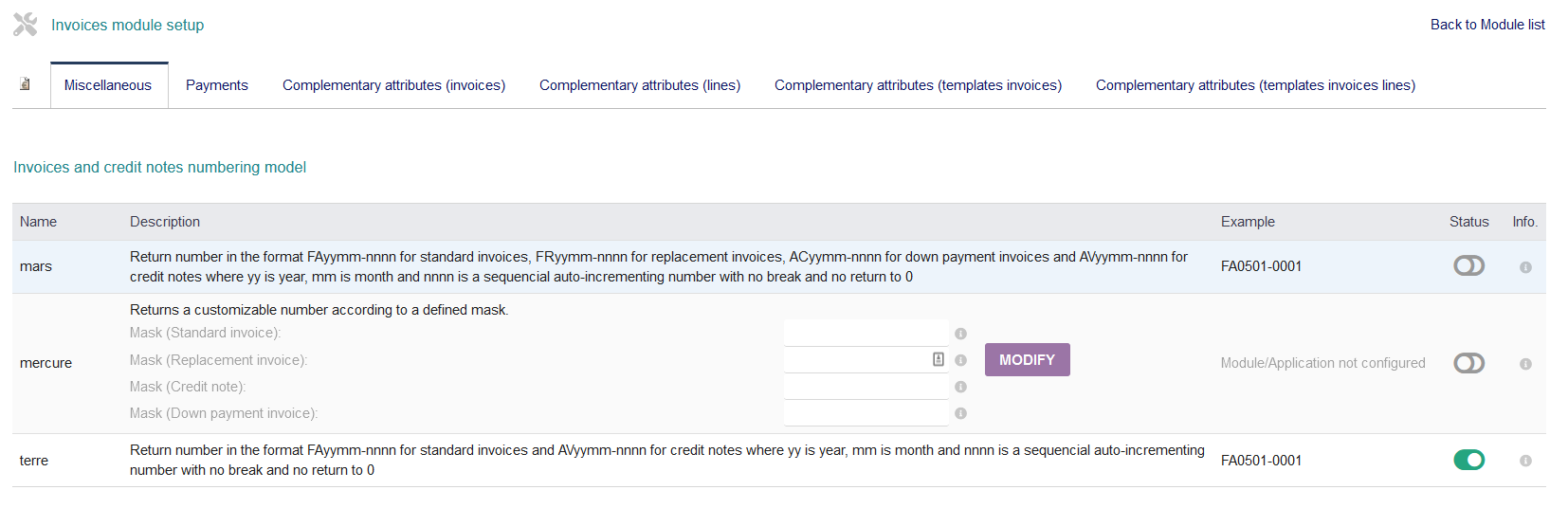

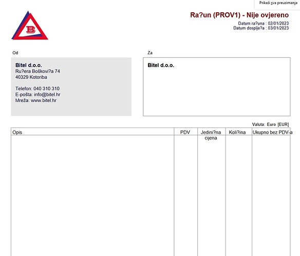

Hello. Again me. I have problem with few special caracters (Croatia) which are not shown on invoice. How to solve this? Thank you
On topic per isseu please.
For this one, we would need more informations, dolibarr version, where does the issue appear etc…
Of course. Version is 16.0.1.
Issue is on invoices when I create them. I put what is problem in attachment. Thank you.
Go to “Home > Setup > Other” and add constant MAIN_PDF_FORCE_FONT with value DejaVuSans
Thank you. Works great now.
