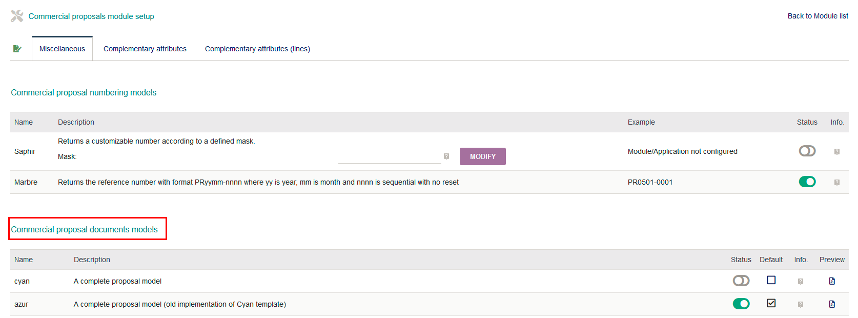

Then put your models on /custom/mybieautifullmodule/core/modules/propale/doc
Then activate the module, and you should see the new template on propal module configuration.
Then activate the new template
