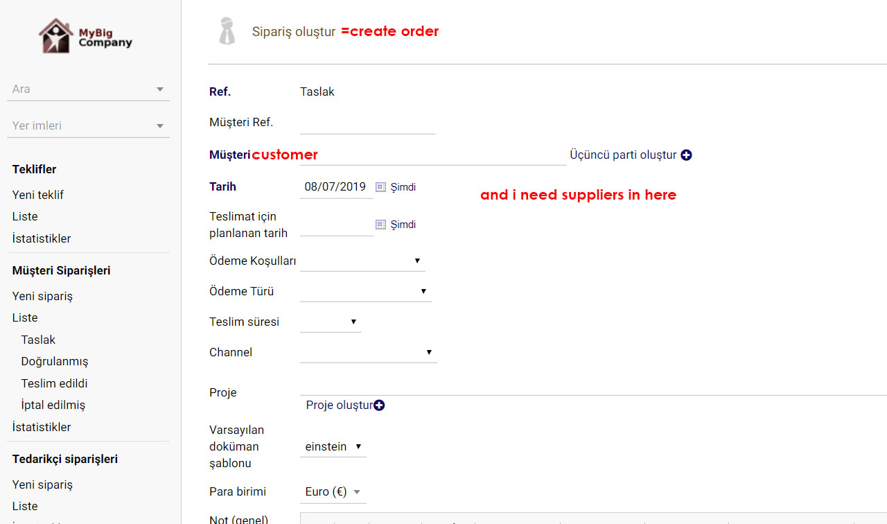

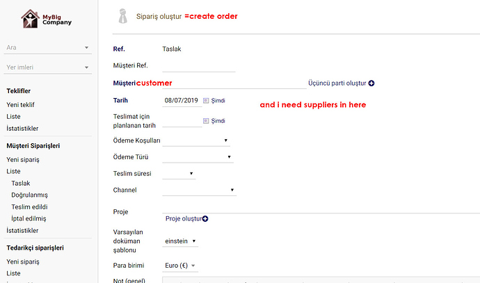

Hello.
I need, supplier lists when i create order form. if possible? i tryed in Complementary attributes but i got error code. i dont know
Please be more clear in your question
Upload or add your suppliers as customers they will then appear there
thank you ariffidaali. but i need both. there is should be both. we are an intermediary firm. I should get supplier and customer reports.
you must create your third parties (customers / suppliers) or import them with import tool.
than you can use them in the business documents.

I produce products at the manufacturer. and I’m sending it to another client from here. Then I make a commission invoice to the producer.
I have to create both the manufacturer’s order and the customer’s order. or what?
This is a waste of time for me

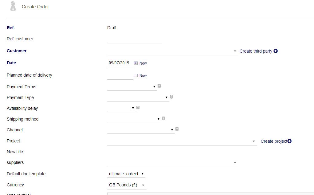

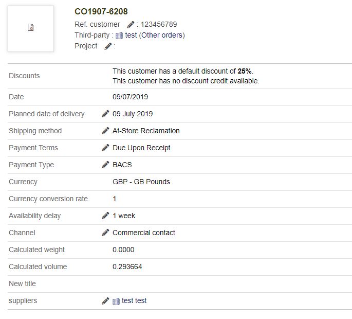

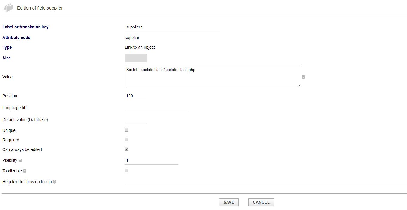

Go to Home-Setup->Modules/Applications->Sales Orders->Complementary attributes and add “New attribute” (Sales Orders can be called Customer Orders in your case)
Select type as a link to an object and fill out the rest of the fields like on the attached image
Then you will have a drop-down list of all Third Parties where you can select your supplier
The supplier will be displayed in the Customer Order
as well as on the Customer Orders list (as long as you select it)
Wow Thank you so much futurehousestore

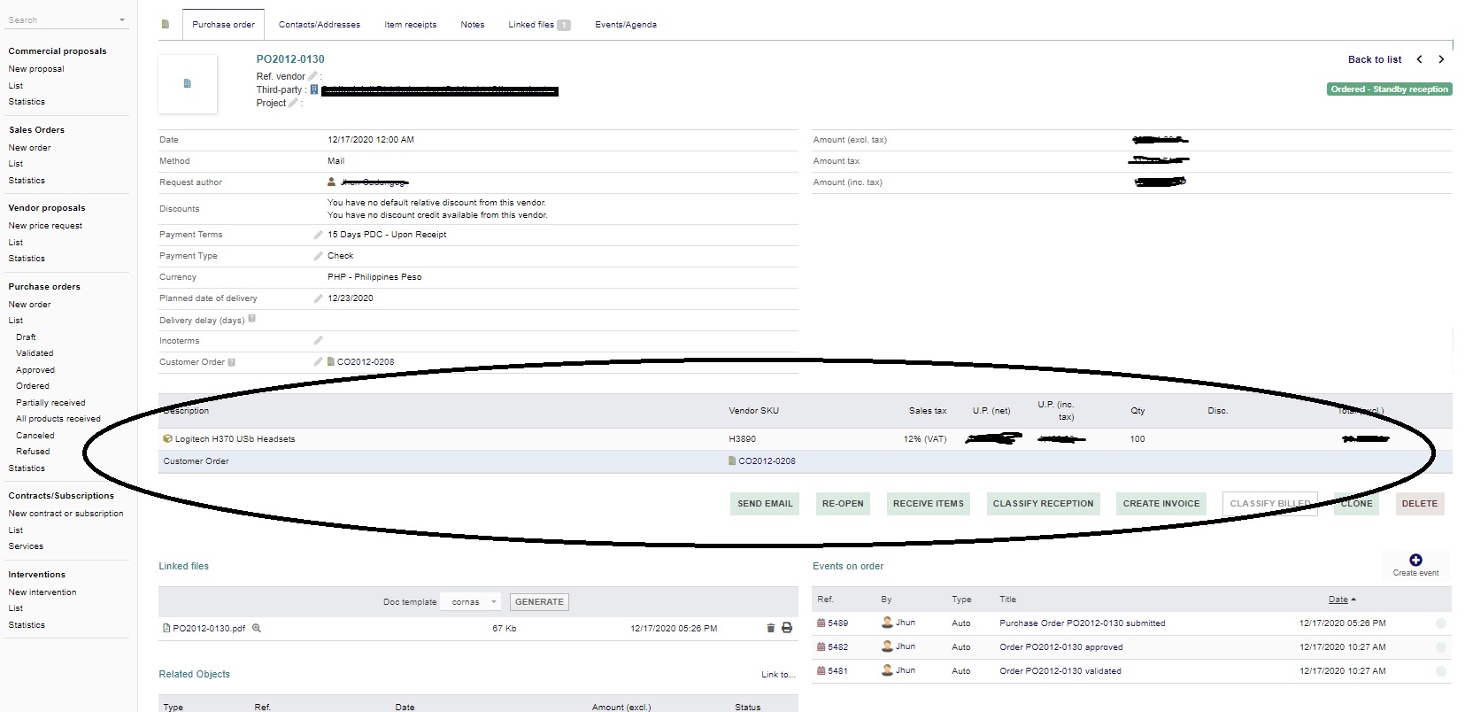

Sorry for the Confusion:
OUr Scenario is this. OUr Customer issue Customer Purchase Order to us and we Issue the corresponding Purchase Order for Vendor of the product.
In Most cases, CUstomer Purchase Order are consist of Different products supplied by Different vendor. So I may issue 3 different Vendor PUrchase order for different suppliers/vendor for a Single Customer Order. To track Which Purchase order was issued to the Vendor Covering Particular Customer Order I implemented the below Code in each order line in the Vendor Purchase Order.
- When I create corresponding Vendor Purchase order to a Customer Order: using the code in Complementary Attributes " societe:societe/class/societeaccount.class.php" I was successful to add the Customer order Number details in the Vendor Purchase Order.

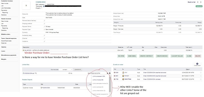

Once I delivered the Items to Customer , I will create the Customer Invoice.
IN customer Invoice what I wanted to achieve is for the Dolibarr to allow me to Select the corresponding Vendor Purchase Order number covering the items Delivered to Customer Premise,
The process should be the same as:
" societe:societe/class/societeaccount.class.php***" - This once display a Drop down list for Customer Order
I need the corresponding command that display the Vendor Purhase Order number instead.
