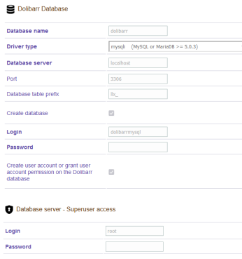

I need to connect MySQL Dolibarr at other server that I have install Dolibarr.
But the problem is, when I need to connect MySQL database, with dtabase name = dolibarr, the system ask the root password. Actually when I installed Dolibarr yesterday, no Information about root password.
Any know about root or dolibarrmysql pasword default ?
Thank you,.
Regards from Indonesia
You need to un-check the “Create user account or grand user”
So I need to reconfigure dolibarr ?
What happen with my database after I reconfigure it ?
Cause I have fill some of data…
Thank you
So I do not understand your question.
Can you please explain ?
Root password : You may have provided during the first installation : No possibility to know it in Dolibarr => Need to see on the server side
Dolibarr mysql login/password created during the installation process : It is stored in the file /Conf/conf.php
