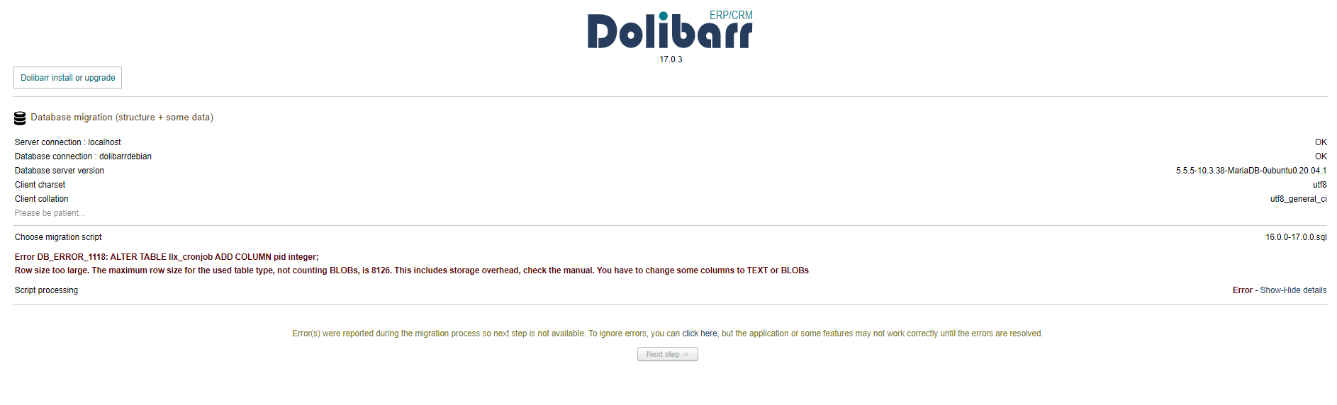

hi guys, it is long time ago since you replied to this thread but I have the same error:
Dolibarr 16.0.3 upgraded to 17.0.3 on Ubuntu 20.04.6 LTS
do you have any idea?
Same as before, verify the inertclass of database and table llx_cronjob
thanks for the reply!
I don’t know how to check this, but I see this on the installation procedure:

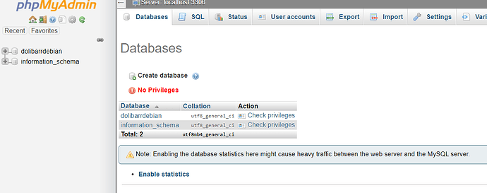

Do you have phpmyadmin ?
Yes I saw that client side is OK, but at least some of your MYSQL tables utf8mb4_general_ci instead of utf8_general_ci

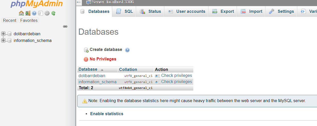

click on dolibarrdebian database
http://x.x.x.x/dolibarr/install/repair.php?force_utf8_on_tables=confirmed
my man, you’re a legend!!!
everything is ok, doing some checks now but I don’t see any issues so far
THANK YOU
