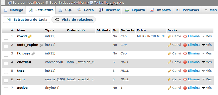

The problem is during install process, in the step when the SQL are executed to create tables and insert some reference data (regions, departments, etc…). I’ve attached here a text document containing the list of errors when trying to insert regions and departments:
DB_ERROR_1366 - INSERT INTO llx_c_regions ( code_region, fk_pays, cheflieu, tncc, nom, active) values ( 10201, 102, NULL, NULL, ‘Αττική’, 1); - Incorrect string value: ‘\xCE\x91\xCF\x84\xCF\x84…’ for column ‘nom’ at row 1
DB_ERROR_1452 - insert into llx_c_departements (fk_region, code_departement,cheflieu,tncc,ncc,nom) values ( 1,‘971’,‘97105’,3,‘GUADELOUPE’,‘Guadeloupe’); - Cannot add or update a child row: a foreign key constraint fails (dolibarr.llx_c_departements, CONSTRAINT fk_departements_fk_region FOREIGN KEY (fk_region) REFERENCES llx_c_regions (code_region))

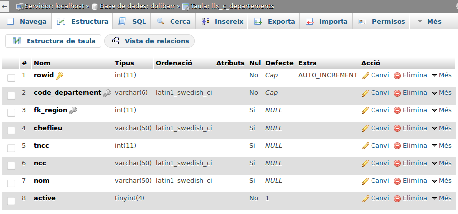

Thanks for your attention Eldy. Yes, i’ve installed an empty environment of the 5.02 on my Ubuntu PC (so local machine). Previously i had installed the Github 0.0.0-alpha version, but i deleted it and afterwards i downloaded the 5.0.2 from SourceForge to work with the “last” stable version. So, before to run the installation of 5.0.2 i removed ALL the tables from database (i named it “dolibarr”) from PhpMyAdmin.
I attach now 3 files:
- dump of the errors printed by dolibarr on web browser during installation
- screenshot of tables llx_c_regions and llx_c_departements
Indeed, i’m searching any webpage where to learn about differences about 3.X versions and 5.0.X. I’ve seen that the most of external modules are for 3.X Dolibarr versions, so i suppose that a 3.X installation of Dolibarr is (by now) more completed for a production environment. Am i wrong? What do you recommend to me to have a best Dolibarr running just now.

I suspect that maybe the SQL execution got interrupted due to odd russian characters… could it possible? certainly i’m not so good in MySQL management. If we look the error message that i shared with you in my firs comment:
It really say: “Incorrect string value”… ! so this probably interrumped the execution of that SQL file, which insert regions on database and afterwards the departements. What do you think?
If this was the reason of the error, then maybe it could be avoided with one of these ways:
- removing from SQL file the russian queries
- modifying default settings of MySQL server (maybe using PHPMyadmin), like charsets, collation, etc… (i really hate this part, hehehe).
I suppose that the second way is the correct, but sincerely it overpass my SQL abilities.
Arggg… silly boy!!! :unhappy:

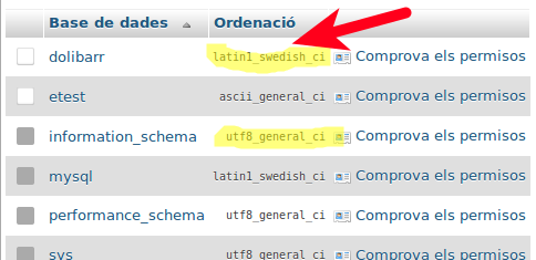

Eldy, i think that i know the cause of the error: i not stted properly the charset for dolibarr database to utf8 !!!
I’m really sorry for make waste your time…
I will remove now the database and i will create again from zero doing again the installation process. I will confirm to you later the result.
Sergi
Effectively, the problem was the charset collation assigned to database. So i removed the first database (from PhpMyAdmin) and added a new one with the same name but collation utf8_unicode_ci, and now the installation went on without errors.
Eldy, thanks for your attention, i only hope that this thread will be helpful for other newbies like me :wink:
