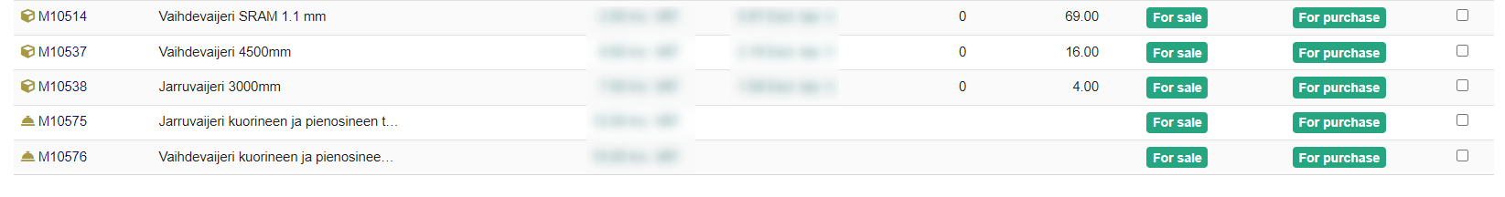

I had the same problem with my bike shop. While most products require stocks and they need to be visible in the inventory, there is a lot of “bucket-stuff” like cables and cable housings, certain bolts and so on, which I don’t keep count of, I just always “have enough” of them
I solved it so that instead of making it a product, I made the cables as service, having similar product number as other products.
Services never run out of stock. It think this could work for software also, you will always have enough bits…

I have not noticed any side effects. I have used this method since I started using Dolibarr. The cables housings have been on the list since 04/04/2014.It shous up or order confirmatiosn, delivery notes and invoices just like it would be a “normal” product.
Only thing I had to “lie” the ID manually. Normally I have separate product (MXXXXX) and service (SXXX) numbering.
It shows up like this, so only difference is the icon and - of course - the stock status:
