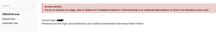

Updated from v11 to version V12 of dolibarr. Now in DMS/ECM module when I am trying to upload a file. I get an error -
“Access denied.
You try to access to a page, area or feature of a disabled module or without being in an authenticated session or that is not allowed to your user.”
Module is active. I am an Administrator with all permissions granted. Any posible fix ?Am I missing something ?

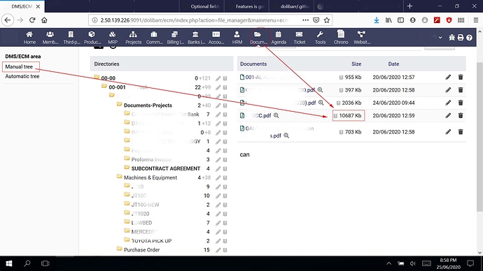

Mr. Rekagi, either your file did not match the specified file size or file format but there is a fixed if you have access to admin or on the server. Please find the picture below:
I hope this will find you helpful. Thank you.

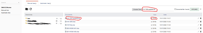

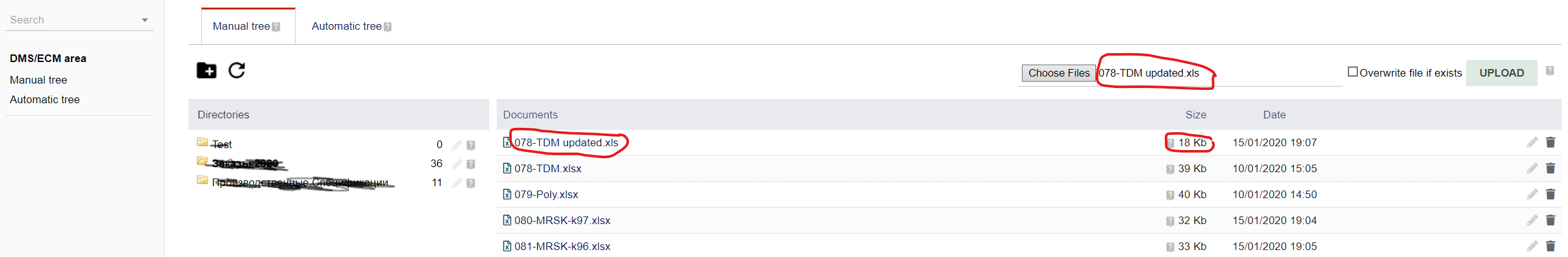

I wish it would be the problem. I tried to re upload the same file that I had with the same name and size of 18kb nothing worked. Changed the name - nothing worked. Turned the module on and off, Changed permissions, made new users - nothing. But Test upload in Setup -> Security is working fine. AND yes I do have acces to Admin and server. IF there is a fix from there please let me know.

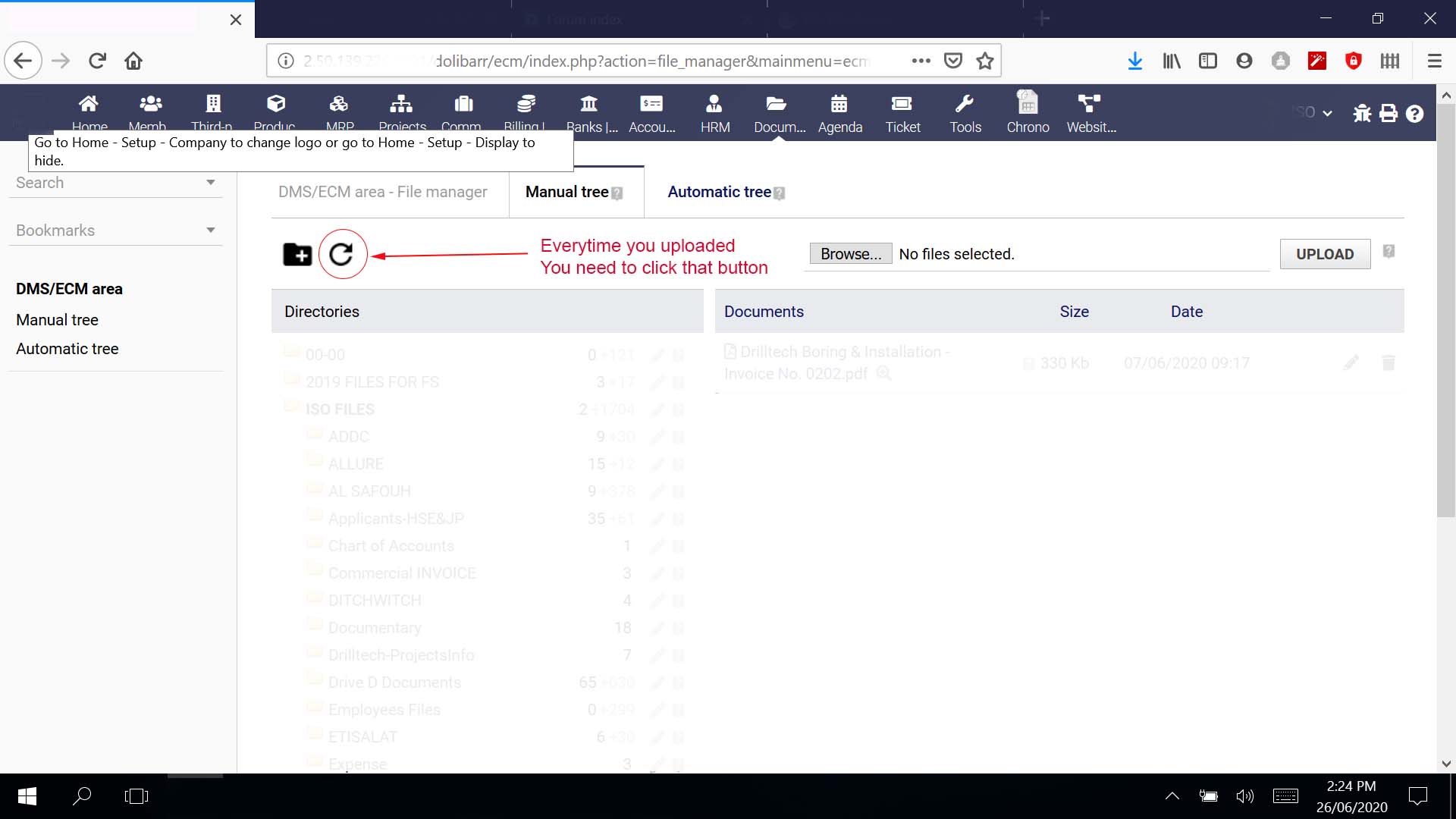

The fix, is to upload the huge file on the server and click that button above, below is the Live Server Hosting the Dolibarr
I hope this can help solve your problem, and note that refreshing those file takes a bit of time to activate it.
