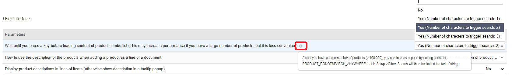

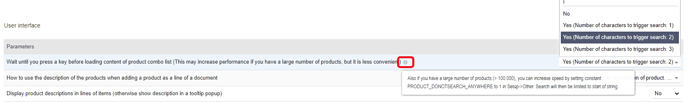

if you change your product/service setup as this
you will be able to search or filter easily !!!
good continuation
Thank you for the quick response. Your solution worked. It takes a couple of seconds for the field to populate, but it’s better than it not doing so at all.
