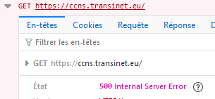

after the upgrade it showed text which indicated to me a possible problem with the php, i changed to a lower version i already tried 7.1, 7.4, 8.1 and 8.2 from PHP.
So far the dolibarr just shows a white/blank page.
the url is ccns.transinet.eu
I hope someone can point me to the potential error over the weekend.
You have an error 500 = PHP Error => Have a look to Apache logs : /var/log/apache2/xxxx_error.log
Thx now it works again, seems the php setup was mixed up after the update as the standard php for ubuntu 24.04.1 seems to be 8.3 best is unload all php and purge it and then only install and load 8.2 if you already installed Dolibarr 19.0.*
