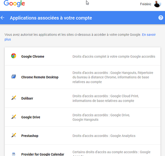

Did you configure printers with google cloud print? https://www.google.com/cloudprint/#printers
Fred

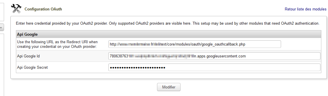

Hello
Example of oauth config:
Fred

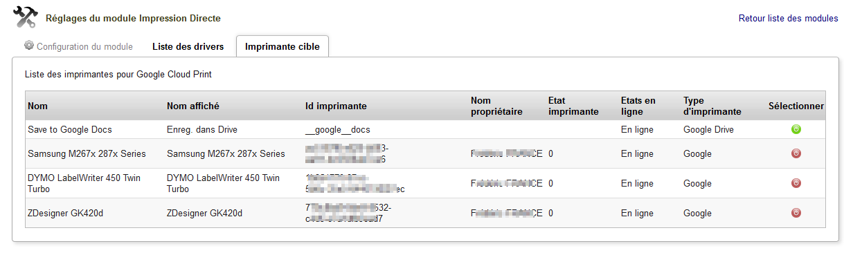

Printer List:
Fred

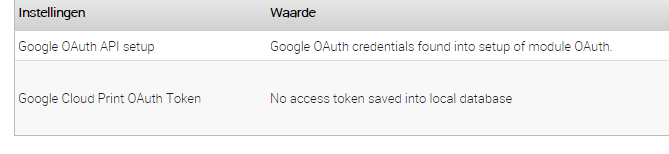

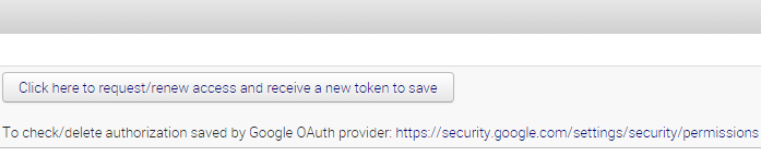

Changed the last code… no error for now.
But the next setting don’t work…
To request en new token, the link ends at my own (error 404)webpage outside Dolibarr. So no token to request.
Click here to request/renew access and receive a new token to save
From GitHub the file getgoogleoauthcallback.php uploaded, the link works…

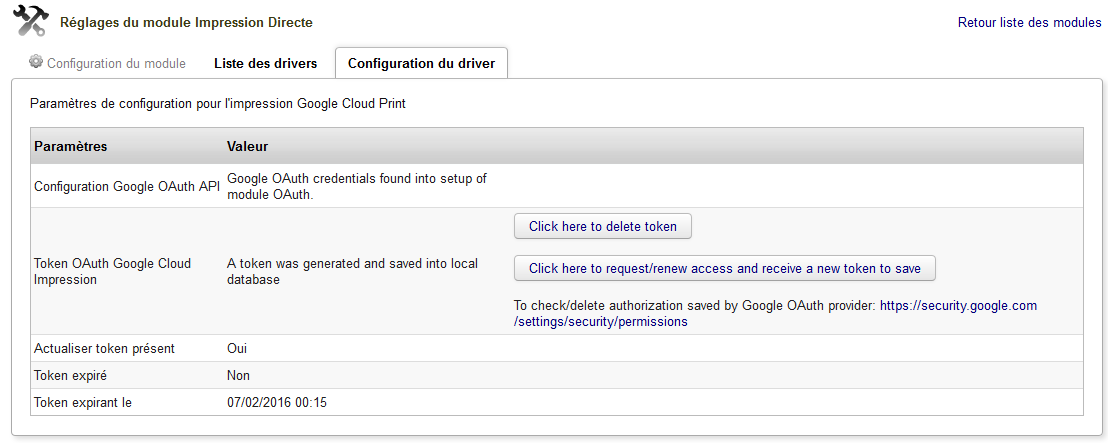

Hello
The file getgoogleoauthcallback.php has been renamed in google_oauthcallback.php and it is why it’s no longer working
you can use getgoogleoauthcallback.php and set this address in google api
Fred
I looked at the code:
~\core\modules\oauth\google_oauthcallback.php (48): $currentUri = $uriFactory->createFromAbsolute($urlwithroot.'/core/modules/oauth/getgoogleoauthcallback.php');
and changed getgoogleoauthcallback.php to google_oauthcallback.php
Finaly it works :happy: Thanks for your patience, help and time !!
